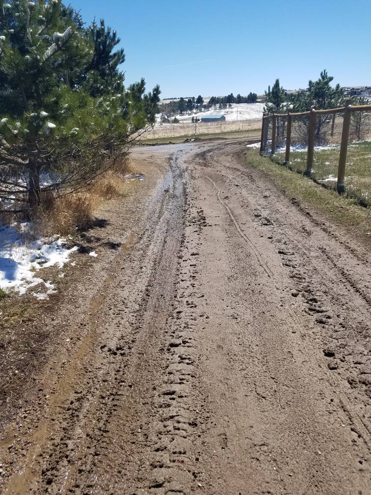

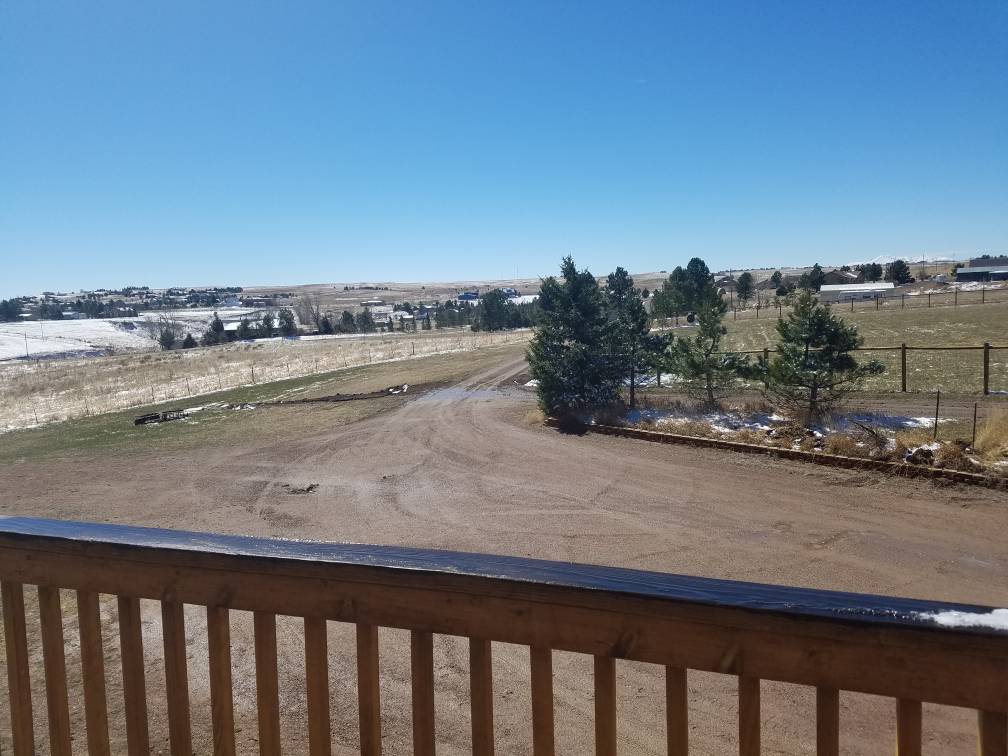

Well it's not working at all based on the snow melt the other day. But that was expected until I re-grade the driveway up to my shop & ditch the side.
It's carrying the traffic fine, which is my main concern for now. Needs regrading already as it packs down a bit lumpy, but no surprise or big deal there. 20170405_114325.jpg20170405_120232.jpg
It's carrying the traffic fine, which is my main concern for now. Needs regrading already as it packs down a bit lumpy, but no surprise or big deal there.View attachment 506310View attachment 506311
You'll get the grade properly cut and it'll work fine!!! Expect some lumpiness for awhile. :)
