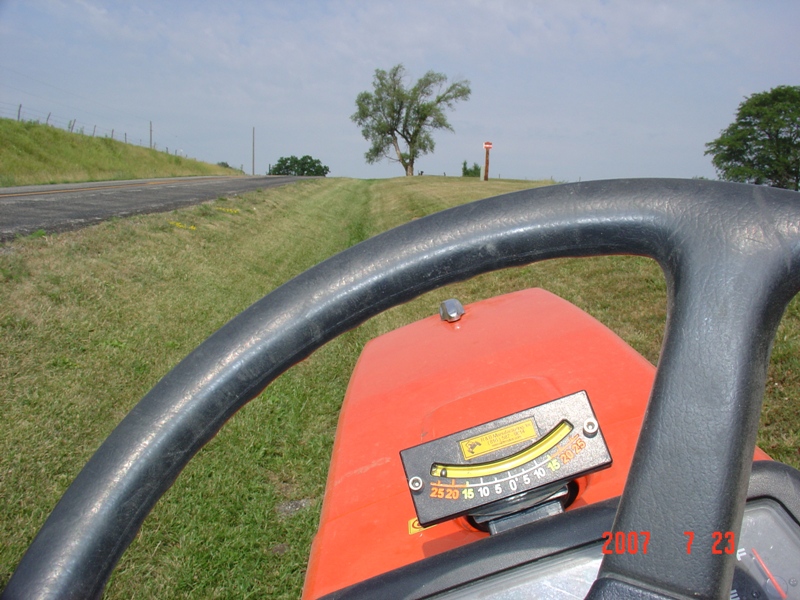

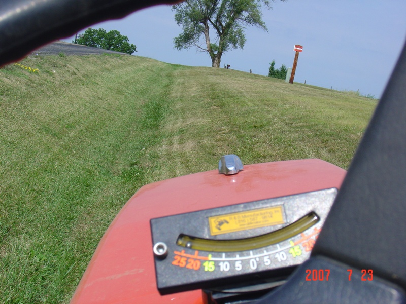

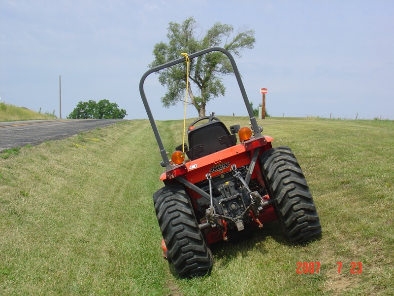

Everyone should make their own determinations without doing something dangerous just because someone on here said it is safe. With that said, I've attached some pics of my Kubota B2910 with 60" MMM and loaded rear tires. I mow this bank at full Hydro speed in mid range, I'm guessing 6-7 mph?? I never get the feeling I'm tipping over. I tied the "plumb-bob" to the ROPS to give an idea of how steep this is. I mow another bank that pegs my tiltmeter so far I can't see the ball anymore. My disclaimer is stated above. ;)

WOW. Thats what I would call extreme mowing. :p It appears though it is nice and smooth with no hidden surprizes. Be carefull.

Always careful!!! :)

The protractor on the ROPS and "plumb bob" shows that angle to be about 20 degrees, about what most guys here consider the upper limit for safe work on a compact. I think I'd only hit that one with the lawn tractor and it's lower C/G, but your mower and weights are definitely helping you out there.

Yeah that's what I thought when we purchased the Kubota after having used the JD 455 for a couple years. But surprise, the Kubota will mow slopes the John Deere wants nothing to do with. So now I mow the hard stuff with the Kubota while the wife mows the easy stuff with the JD.

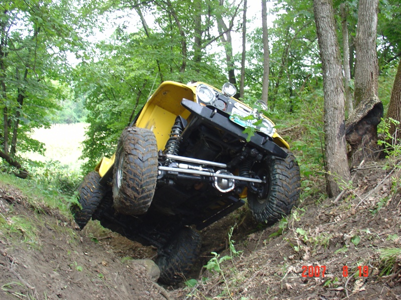

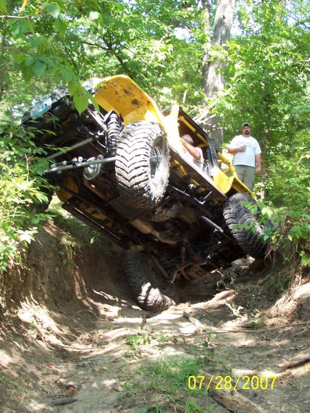

I'm a Jeep Nut and regularly have my Jeep at 45 degrees so 20 degrees isn't a big deal. But, as I said at the beginning of this discussion, you should never go on a slope that you don't feel comfortable with just because someone says it's okay. Use your gut feeling.
