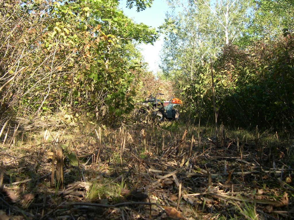

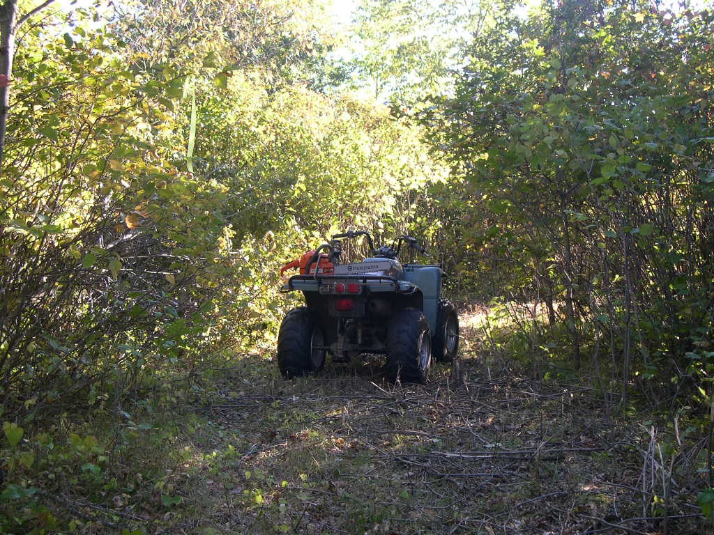

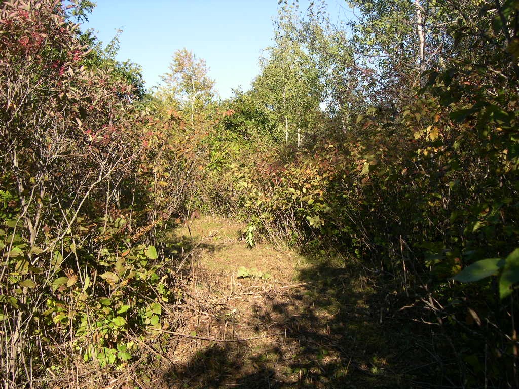

15 hp Shibaura with 4' KingKutter cut 8' brush for these trails. Made quite a racket!
