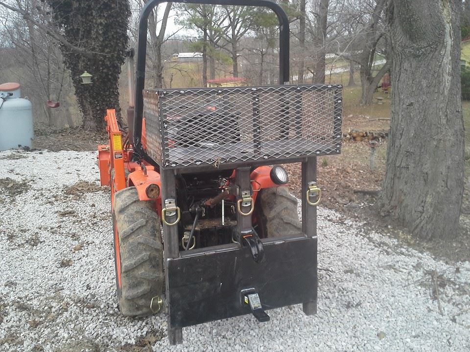

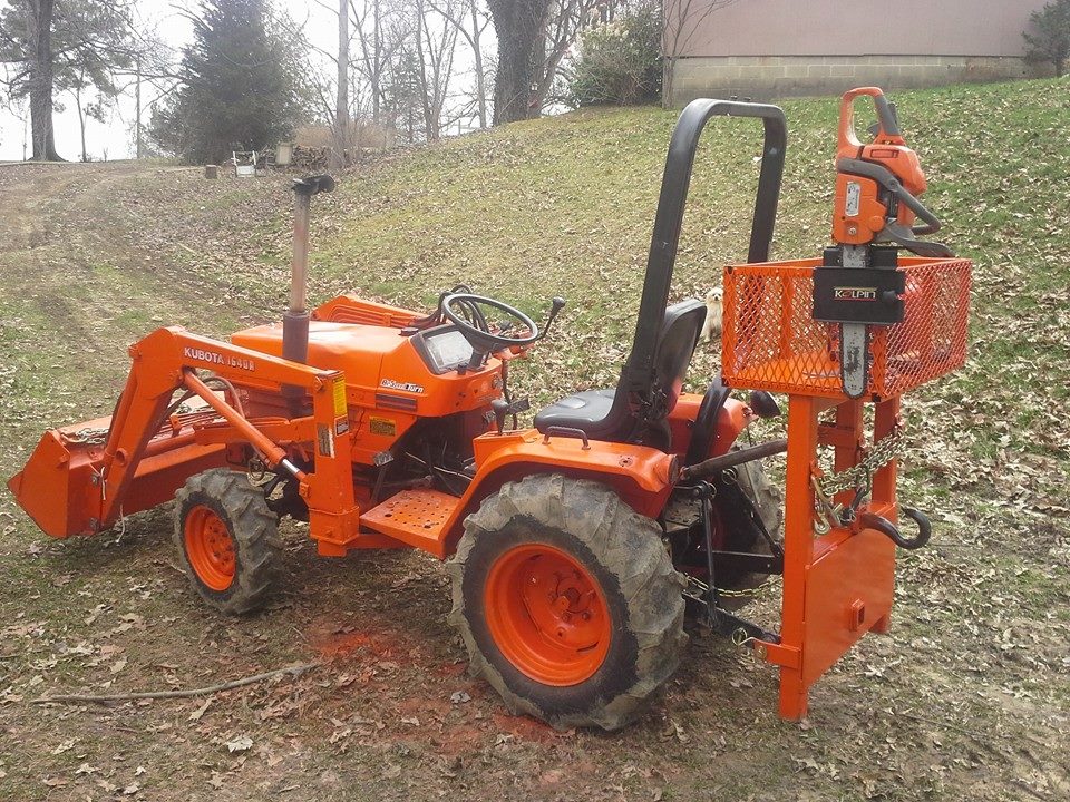

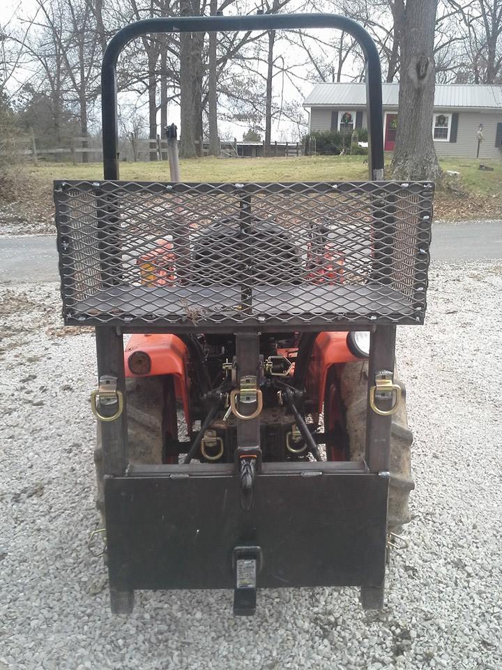

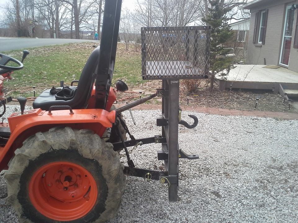

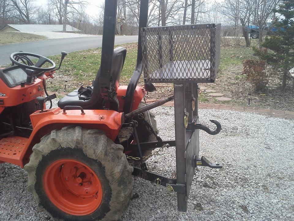

i have been using a small kubota b1750 sub compact tractor ( 20 hp ) for a while. i drive it two miles from my house, to my 15 acres for doing work on it. i needed a way to haul tools with me, chainsaw, oil, fuel, water, oil, nails, and other assorted stuff i needed, i made up a combination counterweight / tool carrier / logging hitch. i love the **** thing. its great. i can carry a cooler, chainsaw, chains, tools, etc... plus its a counterweight. ( it weights 250 empty), but i could have easily doubled or tripled that with adding lead or concrete and filled the tubing. i just bought a like new, 2014 kubota L3901, ( with 29 hours on it)... and im finding my tool rack does not quite fit the bigger tractor, so im about to start building a larger one, that sets back approx 6 inches more ( to prevent accidently hitting the tail lights)... ill make it a foot wider, and probably build a winch mount into it, and add a 3000-5000 elec winch, to do my logging stuff. anyway heres my logging hitch / counterweight / tool carrier i have now.... the new one will weigh at least 500lbs... possibly even more. iv learned a few things while using this one, that i will implement in the new one. i cannot state how much i love this thing. if fencing, you can add a receiver hitch barbed wire carrier......or any kind of receiver hitch type tool / carrier etc. my next one will be a bit wider.. and have a lot more weight to it. probably put a blade and a 45* angle on the bottom 4 inches, to allow it to dig into the ground when im winching something from the rear... and use a electric winch..... if i was going to be using it a lot, ifd get the pto driven winch.

its pretty awesome... im still refining it, but it works extremely well. its all 1/4" thick steel. im very happy with it... it just does not fit well with the new tractor... ill either modify this one a little, or build a new one.... most likely build a new one.
