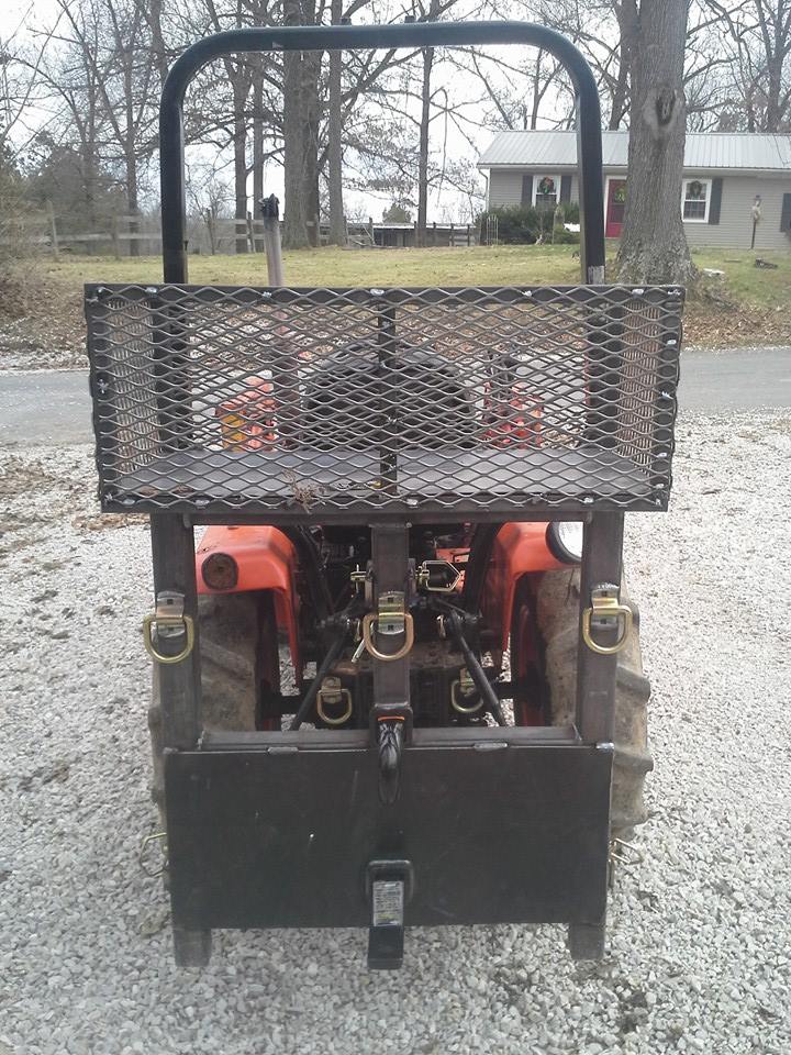

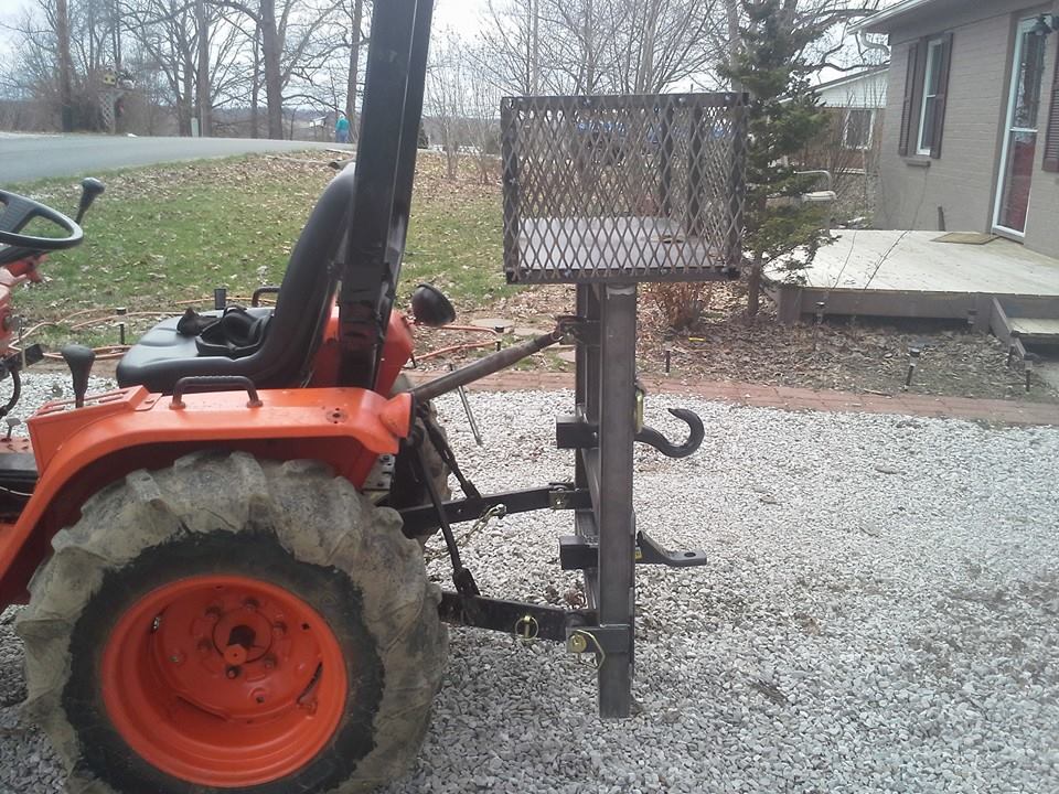

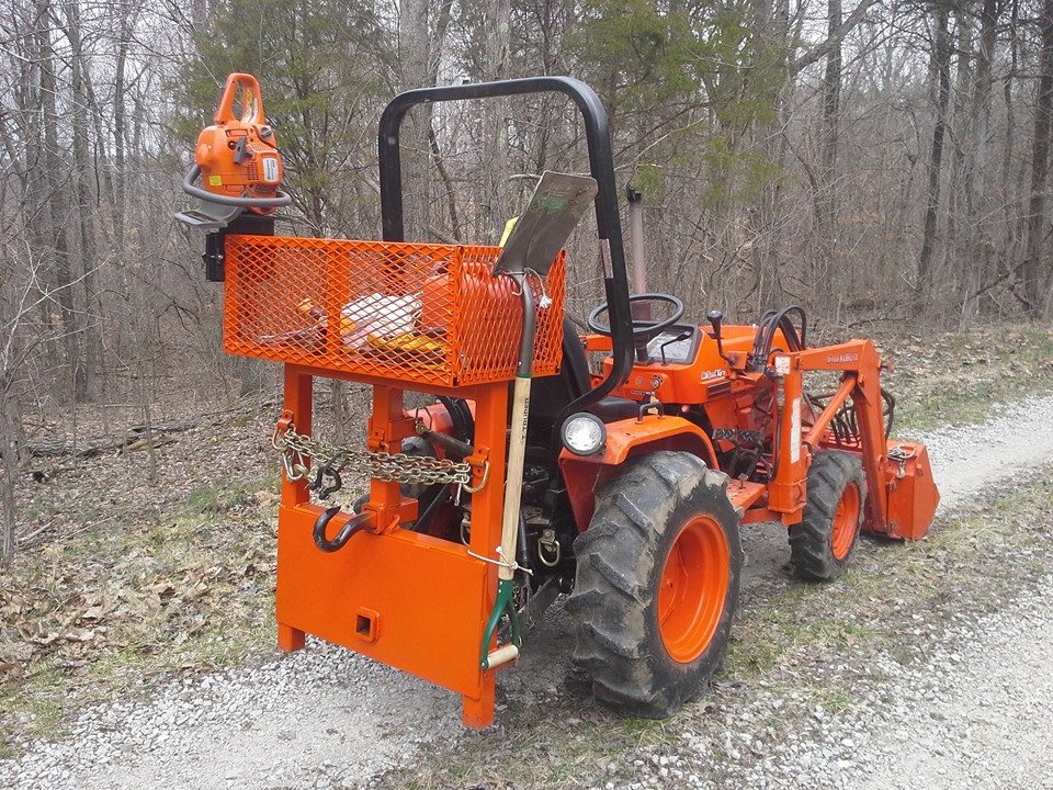

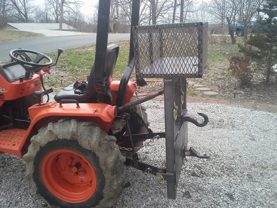

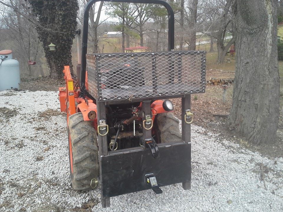

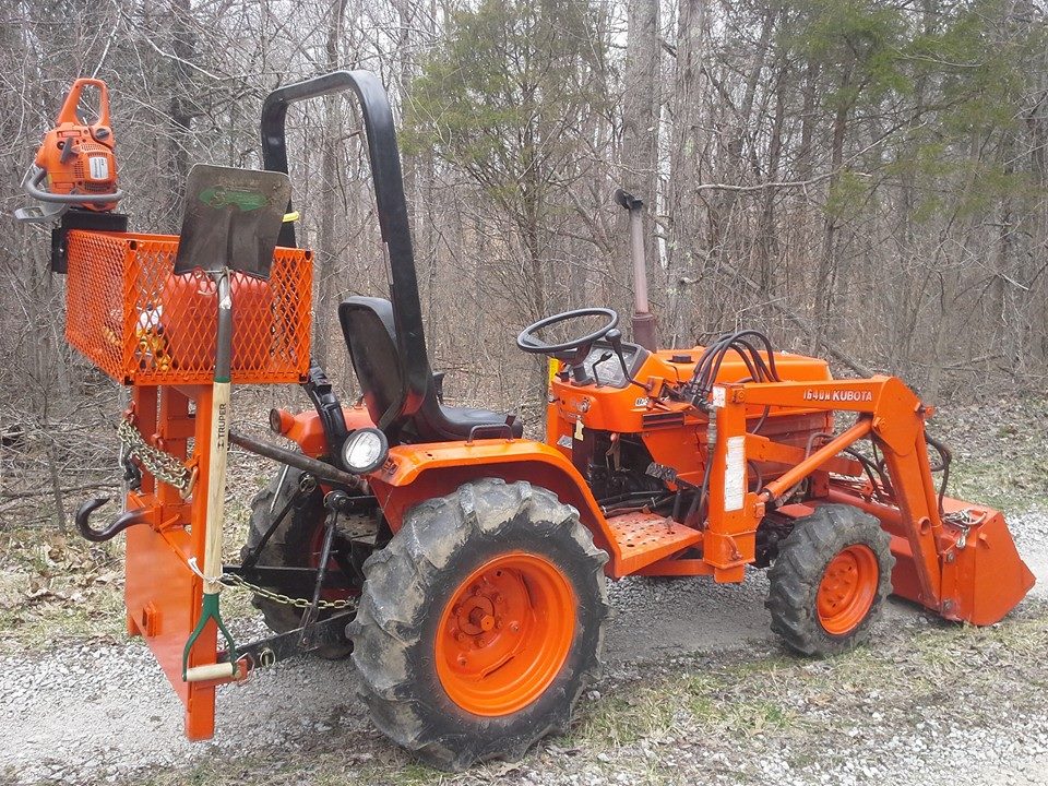

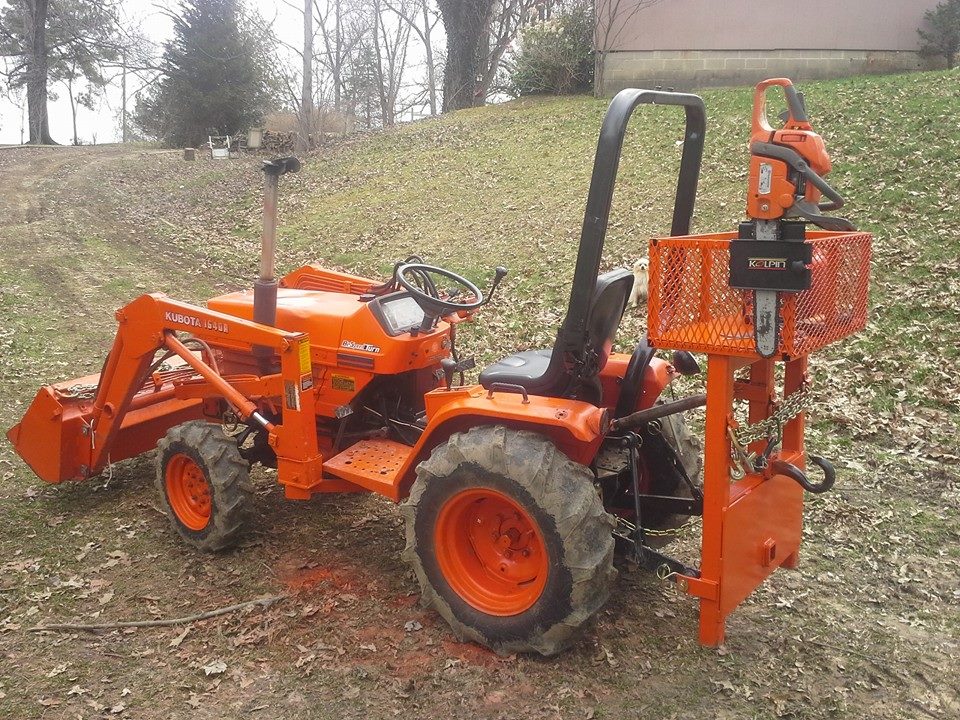

i have been using a small kubota b1750 sub compact tractor ( 20 hp ) for a while. i drive it two miles from my house, to my 15 acres for doing work on it. i needed a way to haul tools with me, chainsaw, oil, fuel, water, oil, nails, and other assorted stuff i needed, i made up a combination counterweight / tool carrier / logging hitch. i love the **** thing. its great. i can carry a cooler, chainsaw, chains, tools, etc... plus its a counterweight. ( it weights 250 empty), but i could have easily doubled or tripled that with adding lead or concrete and filled the tubing. i just bought a like new, 2014 kubota L3901, ( with 29 hours on it)... and im finding my tool rack does not quite fit the bigger tractor, so im about to start building a larger one, that sets back approx 6 inches more ( to prevent accidently hitting the tail lights)... ill make it a foot wider, and probably build a winch mount into it, and add a 3000-5000 elec winch, to do my logging stuff. anyway heres my logging hitch / counterweight / tool carrier i have now.... the new one will weigh at least 500lbs... possibly even more. iv learned a few things while using this one, that i will implement in the new one. i cannot state how much i love this thing. if fencing, you can add a receiver hitch barbed wire carrier......or any kind of receiver hitch type tool / carrier etc. my next one will be a bit wider.. and have a lot more weight to it. probably put a blade and a 45* angle on the bottom 4 inches, to allow it to dig into the ground when im winching something from the rear... and use a electric winch..... if i was going to be using it a lot, ifd get the pto driven winch.

Your tires have taken a beating driving that far for every use.

Buck19Delta: That is VERY cool. I have ideas now in my head to do something similar. G

not a lot i can do about it right now... however...... im going to be building a pole barn garage, with a apartment on the land this summer.. and move into it.... then after another 2 years build a in ground concrete house, and move into that..as finances permit. im just not comfortable leaving expensive equipment unattended like that....
its pretty awesome... im still refining it, but it works extremely well. its all 1/4" thick steel. im very happy with it... it just does not fit well with the new tractor... ill either modify this one a little, or build a new one.... most likely build a new one.

Now that's super cool! :thumbsup: I'm sure you could sell that easily if you decide to build a larger one for the bigger tractor!
