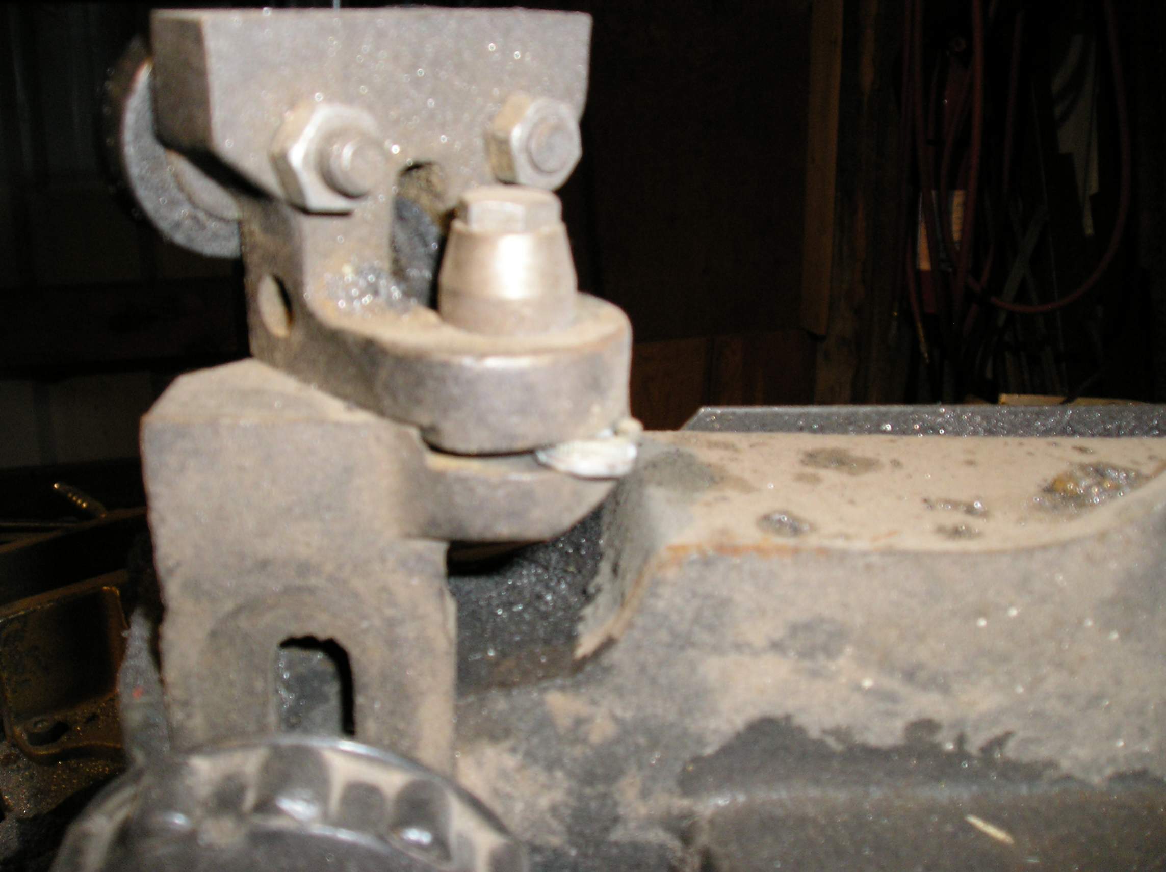

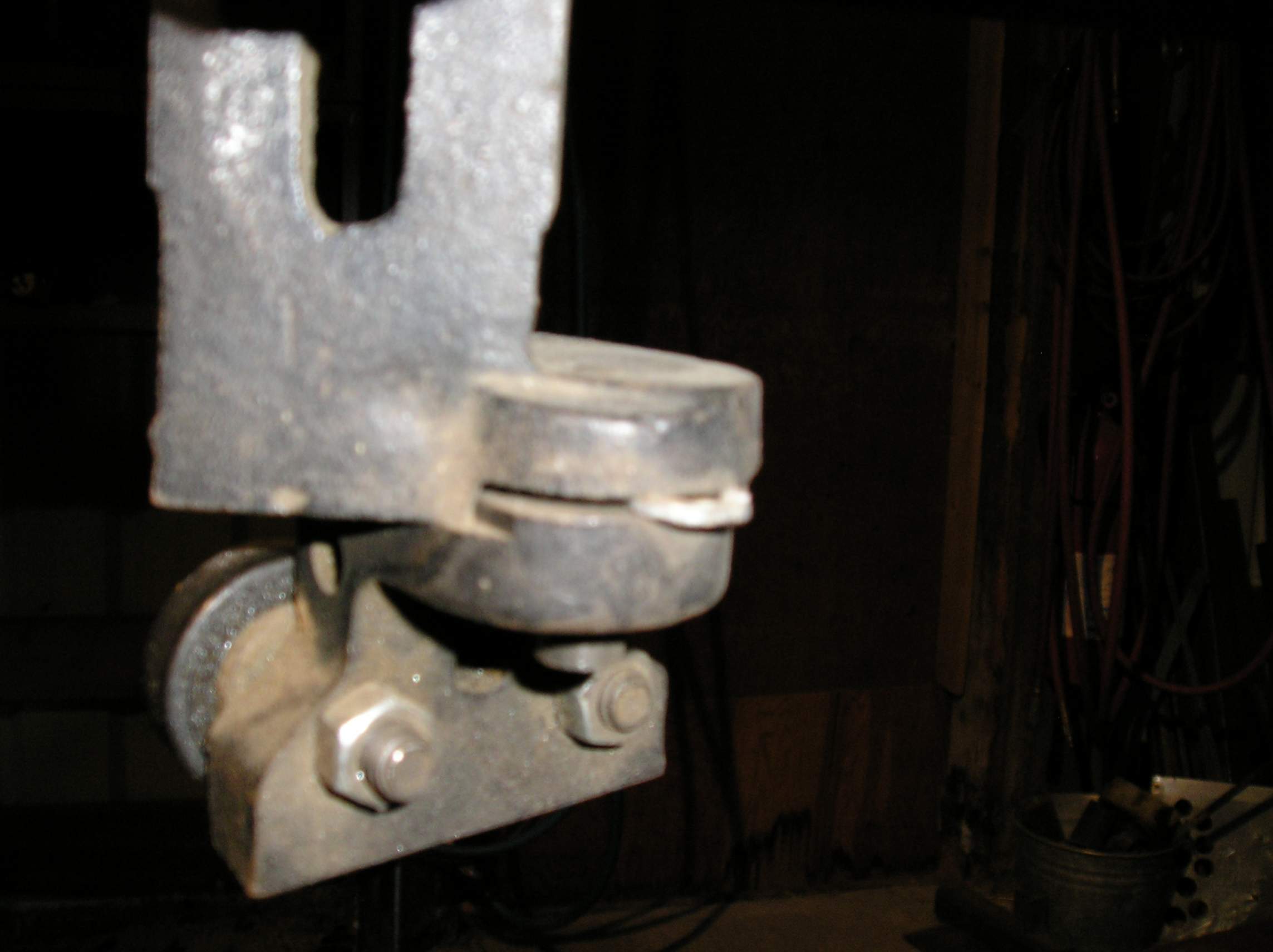

It threw blades for the first 15 years or so. Never could figure it out. It would work fine for 2-3 months then boing! Off would come the blade. Every cut it would come off. Then it would work fine.
Finally I figured out what was wrong.
Stand the saw up so it is in the verticle position. Look at the roller bearings that are on each side of the blade. Bear with me as I try to explain what I mean.
There are 2 sets of bearings. Each on an adjustible arm.
As the band rotates, where it touches the inside of the bearings, The rotational plane of the bearings should be slightly above the plane of the band. I know that doesn't make much sense. Let me say it like this.
As the bearings rotate, Where they touch the band, the band should be forced "slightly" toward the flanged side of the band "drive and idler" wheels.
To achieve this, the adjusters on the double sets of bearings must be shimmed to get the rollers on the correct plane.
Now that most are confused reading this monologue, if you are interested in what I did to make my chinese knock-off saw work like a charm, PM me and I will take pictures of the shims I installed and show pictures of the roller set up on the band and what the above words tried to describe.
This is living proof that a picture is worth 1000 words.

Attached are pictures of my "rube goldberg" (remember him?) fix to my saw. The yellow piece of scrap is laid against the rollers to show the amount of "lift" to the blade to keep it from coming off the drive and idler wheels.
When tightening the adjusters, with the spacers inserted, I brought the roller down until it almost touched the blade. I figure this allows the blade to "float" in its normal track. After all was said and done, the side rollers were adjusted so as to ride on the blade and not allow it flex "sideways" which would allow the blade to cut crooked.
After all that, the blade cut 90 deg to the bed. Something it never did prior to the "rube" fix.
The spacers did such a good job "lock washers" I left them as you can see. 1 washer in the 3rd photo and 2 washers in the 4th. If it ain't broke, leave it alone.
Hope this helps. Good luck, Dave
