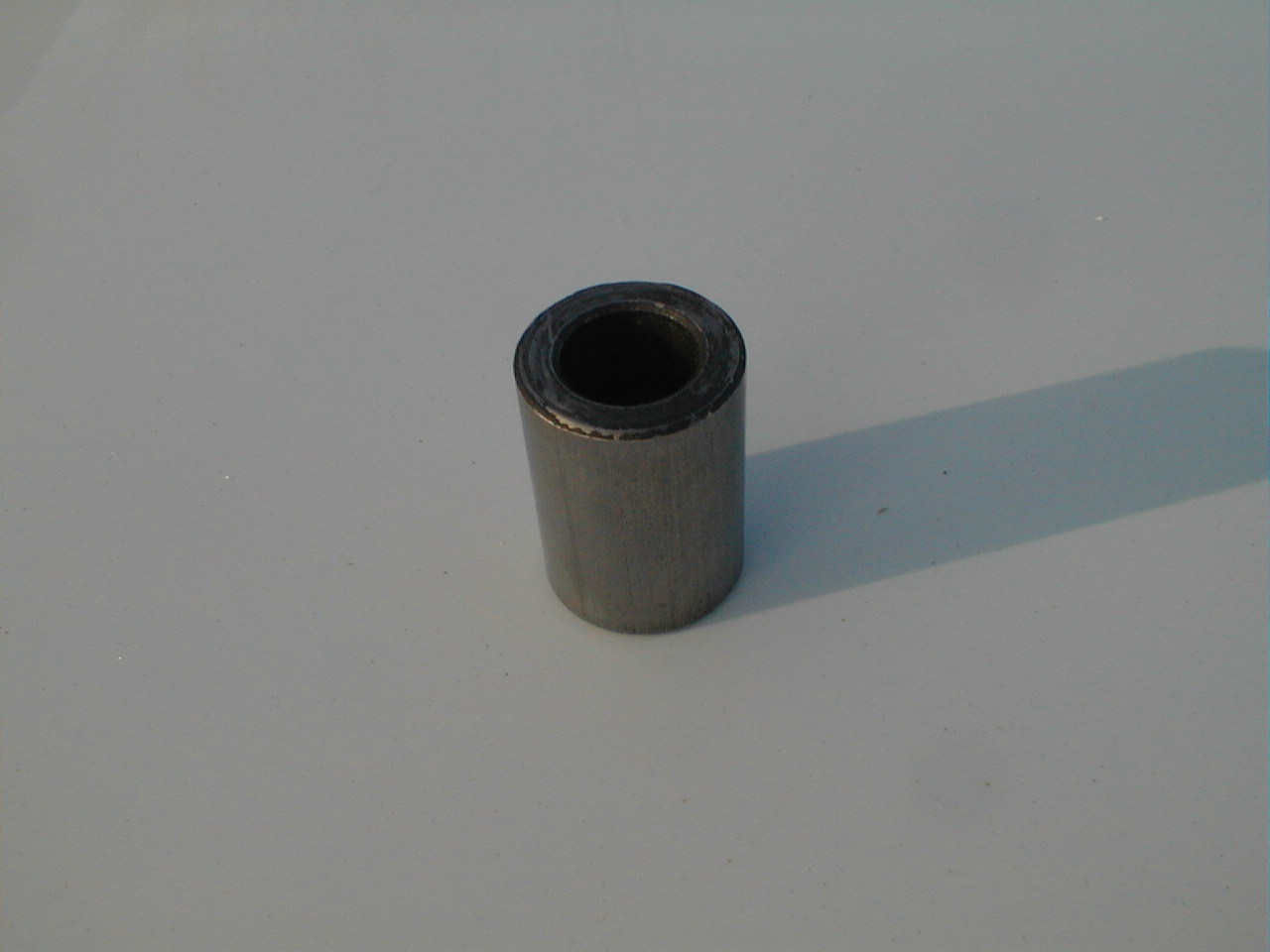

Can you post a picture of the parts? If it's just an oilite bushing (porous bronze), they probably used a standard size you could pick up for a few dollars at McMaster Carr or any good bearing store.
I already exhausted the "any good bearing store option". No luck. I haven't taken the time yet to browse McMaster Carr, but here is a picture of the bushing. It's just a straight bushing. According to my calipers, the OD is a hair over 25/32" (0.785") and the ID is 15/32". Of course the reason I need a new one is because I have too much play between the bushing and the shaft.

   / How Nice is a Metal Band Saw? #63
Can you see the wear on it? With the amount of tension on it I wonder if it makes any difference..
You have another option. If you can't find the bushing you are after, You can also get nearly anysize thin walled shaft adaptor. Many machine shops that do repair have these thin steel slide on bushings that take up the slack between your bronze bushing and the shaft. If you can't find these let me know and I will get you a phone number in MN. Where you may be able to source one.

I'm back to mulling this over again... How I am going to get this bandsaw working.
Seeing as how bushings in 1/32" increments are not readily available, and seeing how duracraft is some cheap store brand, I've concluded that the stuff must be metric. I can't find any bushing that goes from 12 mm to 20 mm so I'm planning on getting two. One will be 12 mm to 16 mm, and the other will be 16 mm to 20 mm. Both bushings are available from McMaster Carr for about a dollar each. Maybe I'll order the bandsaw blade from them too if I'm paying shipping anyway.
Anyone see problems with using two bushings like that?

Iplayfarmer, I would buy shim stock and slip it in between the shaft and bushing. maybe leave 3 thousands clearance and oil frequently. The speed everything turns should not be a problem. I run my saw on the lowest speed it goes and use the standard blade. I found bi-metal broke or wore out too fast and was expensie to boot.

I'd have no holdback on shimming the bushing as you mentioned. I think I'd try switching the bushings around first to se if that will keep the blade from jumping off.
Only problem I've had with the blade jumping was due to improper tension. Not saying that's the same cause that you have though, of course.
