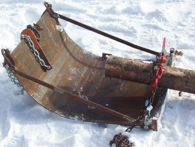

Skid Plate skidder

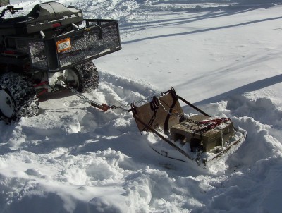

Trail groomer

I still don't see any attachments or descriptions of what happened. What am I missing here.
