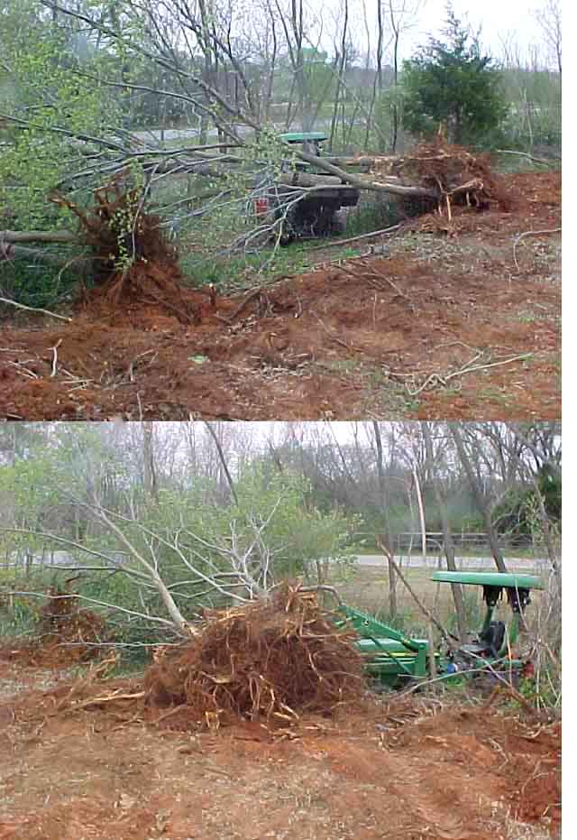

Hard maples get pretty big don't they? Do you move them and cable-cut roots with your 855? I'd like to see pictures of the setup you use, if you can.
Cable cutting sounds particularly interesting, but I wonder if my 855 has enough power to pull it off. What size cable do you use? Do you hook the ends up to the drawbar?
Besides the ornamental oak, which I hoped to transplant, there were several trees that needed to come down around the periphery of our yard. For these, I broke roots around the trees with the backhoe, as best I could, then muscled them over with the loader. Cable cutting would be a nice additional trick to bring trees down.
