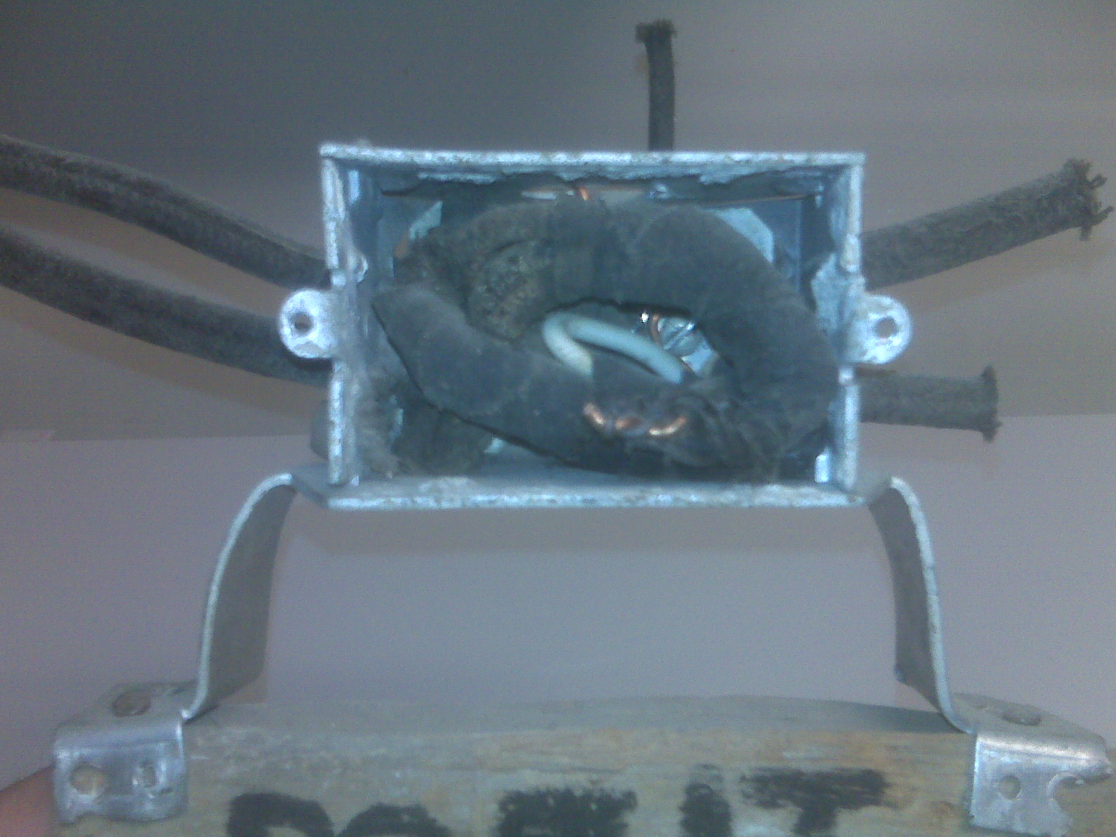

A few weeks back in "Other Forums" I posted a pic of the horror I found behind my 1949 vintage bathroom medicine cabinet...the prior owner of the house, or someone he hired, spliced into the junction box hidden behind the cabinet. The top wire ran down to a cold water pipe. The splice they added is at the lower left of the box. GRS commented 'that is one ugly picture".
Maybe the person who did the GDO here was the same person who spliced into my medicine cabinet box?

Yes, that is FOUR 14/2 wires and one 12/2 crammed into a tiny aluminum box with no wire nuts, just friction tape. I almost had a heart attack when I first saw it.
