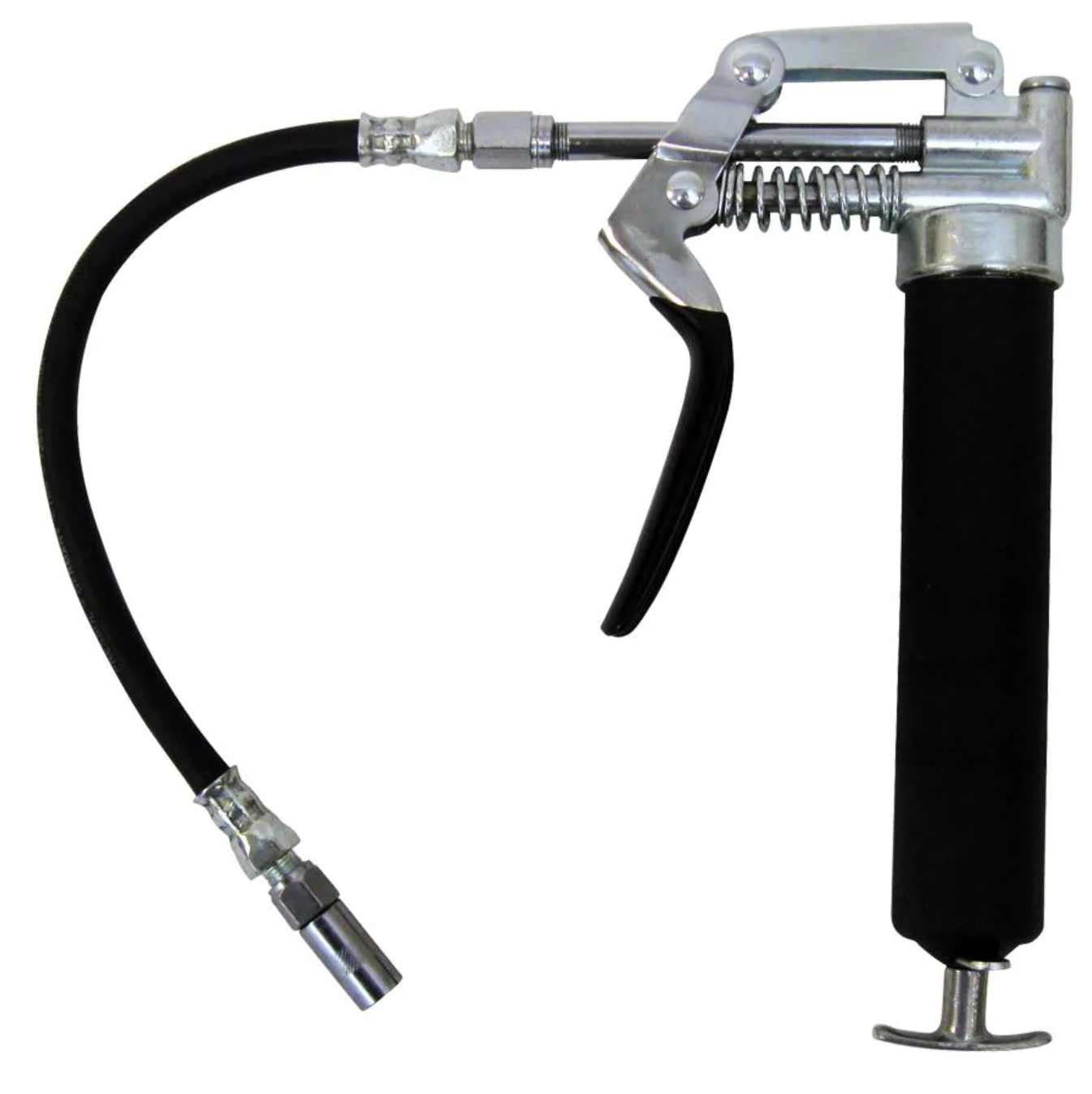

Get the yellow pistol grip. It’s awesome. I was able to grease fittings the battery operated one couldn’t as well as ones I had to jack up tractor to do.
I have several of these. REALLY a nice grease gun. It's even easy to bleed the few times there has been trapped air in it. :)
Don't forget the LocknLube couplers...they are great!

I'm sure that I over grease. I grease PTO shaft joints every day that I use them, the loader joints every day that I use the loader. Better too much than too little. I like to see keep pushing in fresh grease and pushing out any water or grit. Grease is cheap. A flexible hose is essential from my perspective.
