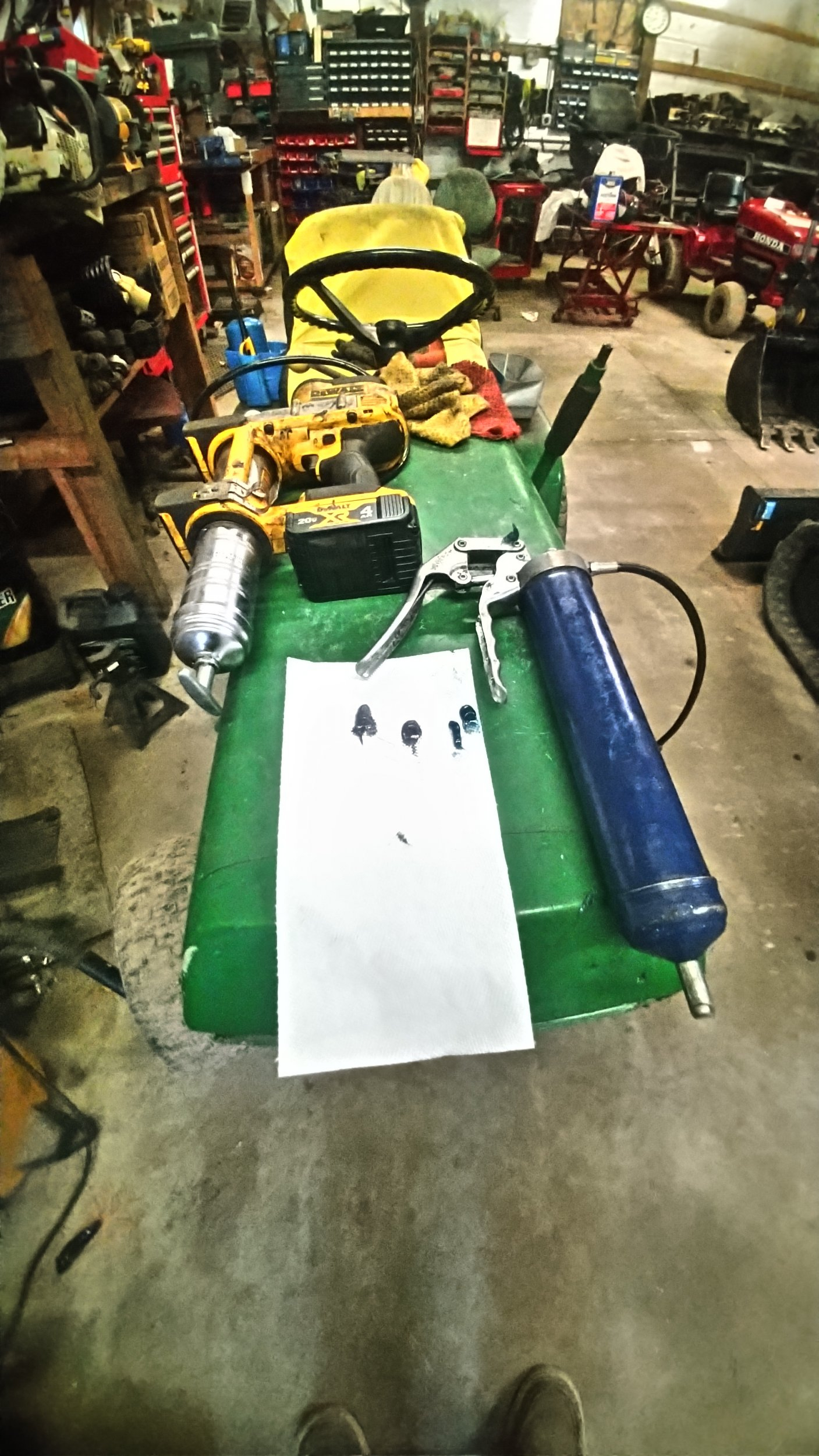

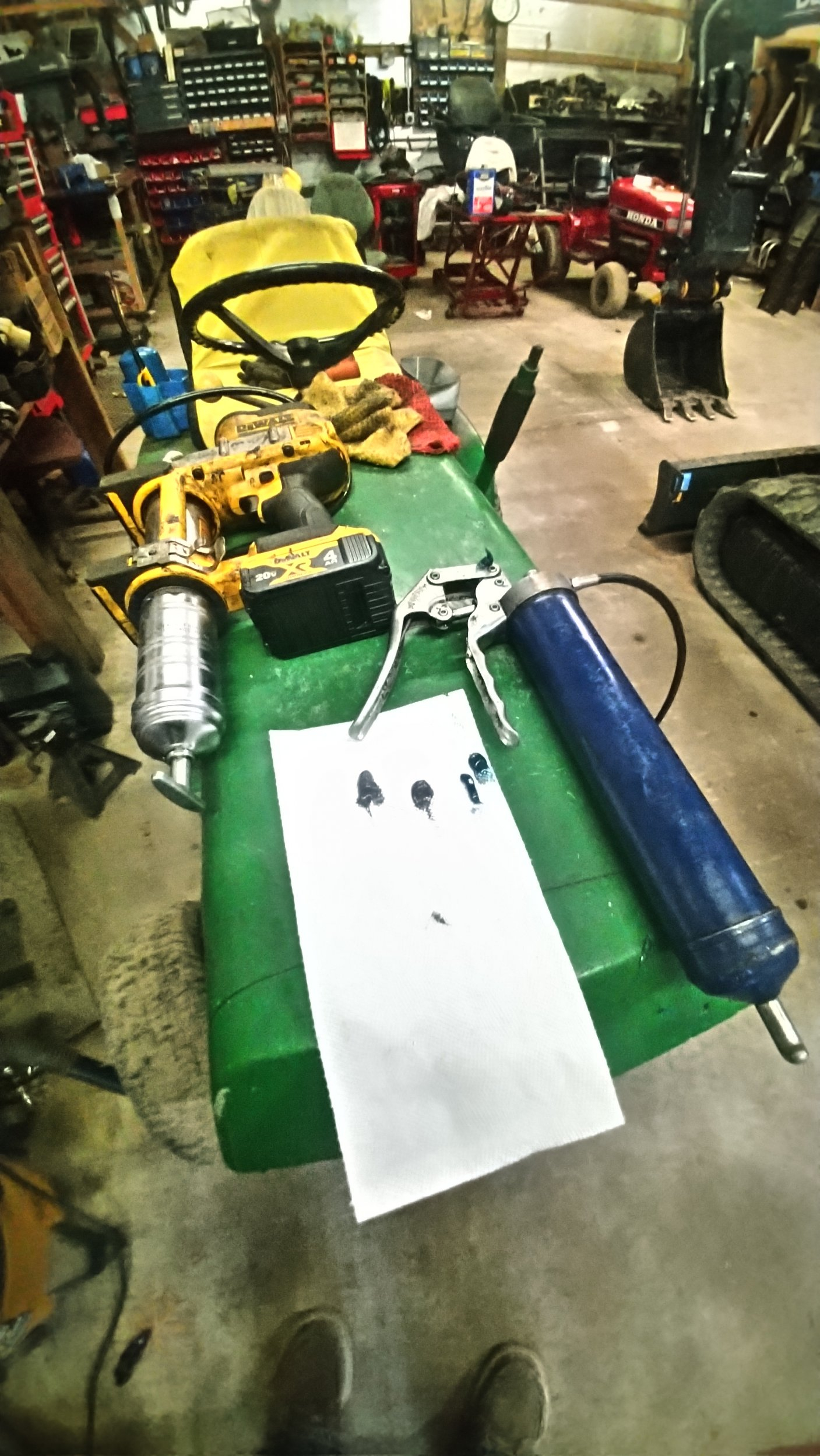

Your post got me intrigued So Tonight had a few extra mins so I tested my DeWalt 20volt grease gun with my old trusty Lincoln pistol grip gun it appears to dispense the same amount with one cycle on the DeWalt and one trigger squeeze of the Lincoln. DeWalt is gray molly Lincoln is blue lithium.

Test on a few actual grease zerks. I did a similar thing initially and it looked to be about the same amount but it takes more cycles of the Milwaukee than either of my manual guns on the actual tractor/FEL/BH zerks.
Again, maybe mine is defective, I just keep it on 5 and hit the trigger once or twice and usually see some sign of grease moving.

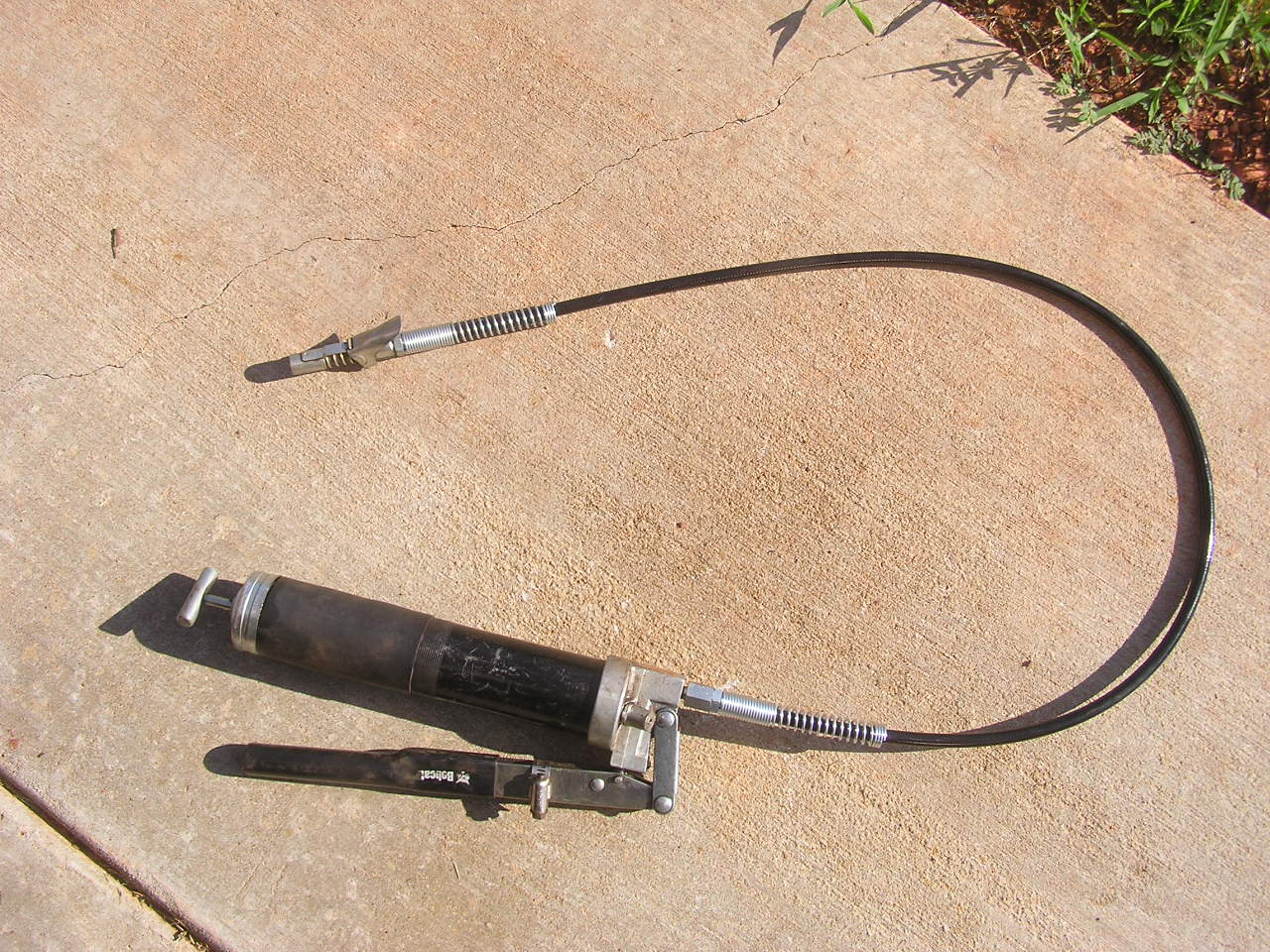

My lever grease gun is rated at 10K.
I have used max pressure by putting it against my chest with the hose down, LockNLube on the stubborn zerk and both hands pulling on the lever.
