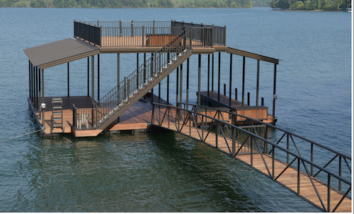

The dock is 15 x30, and the upper deck is 12x15. Yes it will extend out perpendicular from the shore. The gangway is 30' long.
Attached is a picture that is similar to what it will look like when finished.

That’s very nice! If it were mine I would over kill the connection at the shore. No flat bar. Get some rectangular or square tube that looks like it belongs with the structure of the gangway.

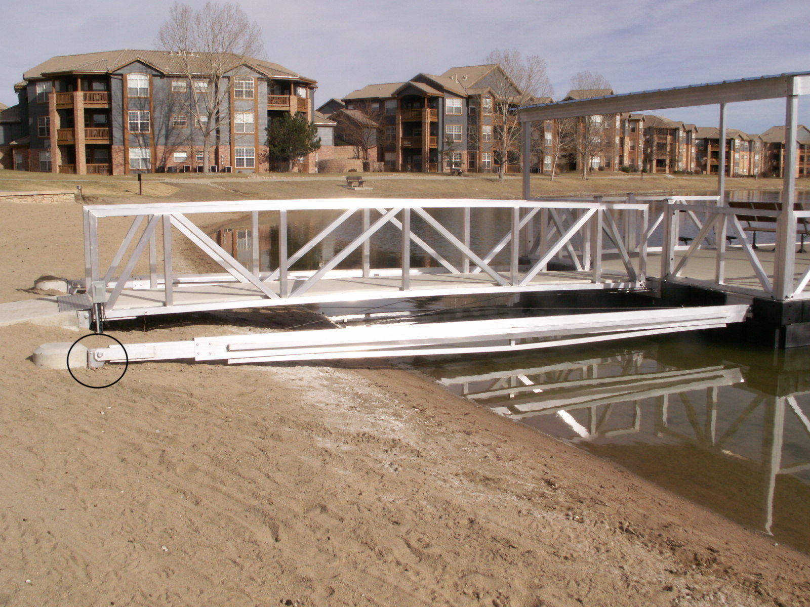

So the flat bars in question are only (part of) an "anchor" to mainly control L/R movement or wind forces?

That will be sweet!
Yes. See the attachment in the circle in this picture.
Instead of bolting it to the side of a concrete pillar or setting a heavy pipe or square tube and welding the mounting tab on to it I was thinking of having the concrete underground and having a 1" x 4" flat strap extending up vertically 12" from he ground and drilling a 1" hole in it for the mount. Basically imagine this picture without the concrete and the mounting tab just sticking up out of the ground.
