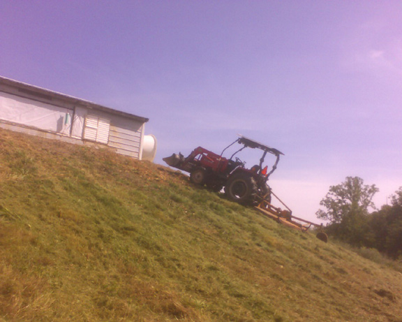

I can't remember to take my good camera, so I shot the slope with my phone. Here is a picture of the slope with my tractor on it.

:eek: :eek: :eek: Man, I'd need one extra pair of shorts for going up, one for turning around and another for coming down again. You'd never get me going up a second time in anything short of a PowerTrac slope mower!:eek: :eek: :D

Actually the last twenty feet where the tractor is, I normally back up because the turn around isn't but about 5 feet wide. It is to steep to angle the tractor and still miss the building I have made my circle and went down at that end instead of up several time. I don't like to do it that way. What I usually do is mow going up and then loop and mow going back down. I leave my loader on so that the front will stay down. It is really tight. The bucket just misses the curtains on the building by about a foot or less. I have to mow that area 3-4 times every summer.

Mornin Jerry,
Holy Cow !!! That looks like the incline on some of our mountains up here !!! ;) :)

John,
I wanted you to see what kind of hill you can work on if you are careful. I wouldn't do it with the backhoe on. A compact tractor with a backhoe on is much to top heavy to operate on that steep of a hill. I don't know if a hydro would be able to operate on that steep of a hill or not because the transmission pickup might be sucking air instead of fluid.

Jerry - That's an awesome photo...And I think it answers the question very well!
