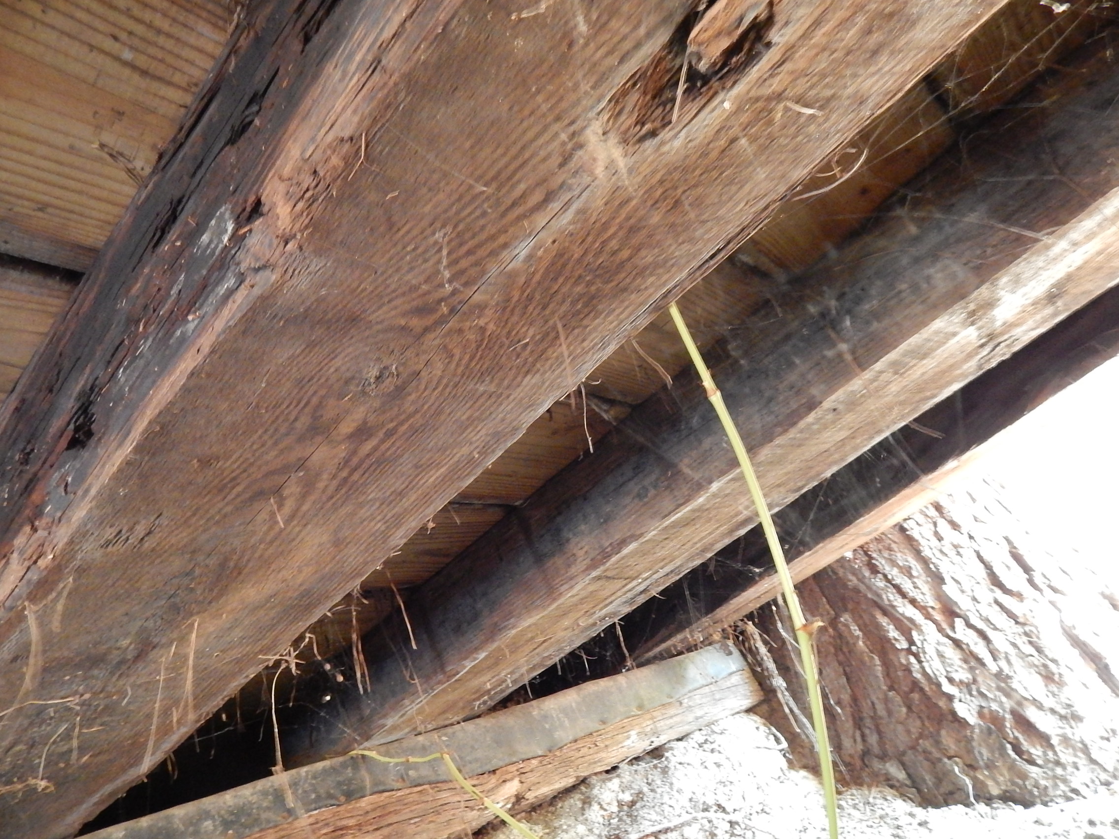

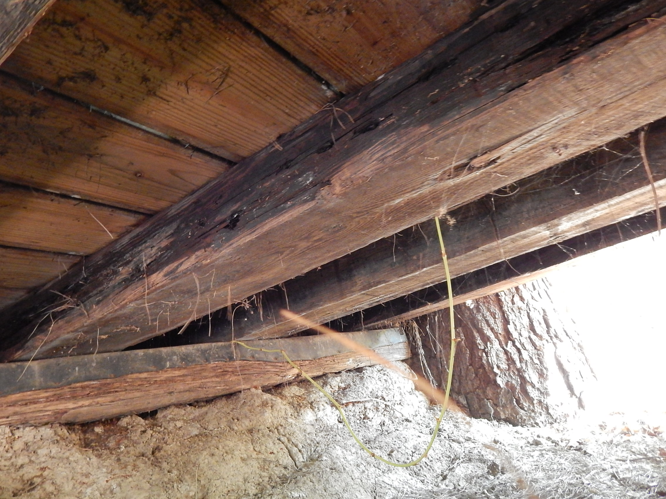

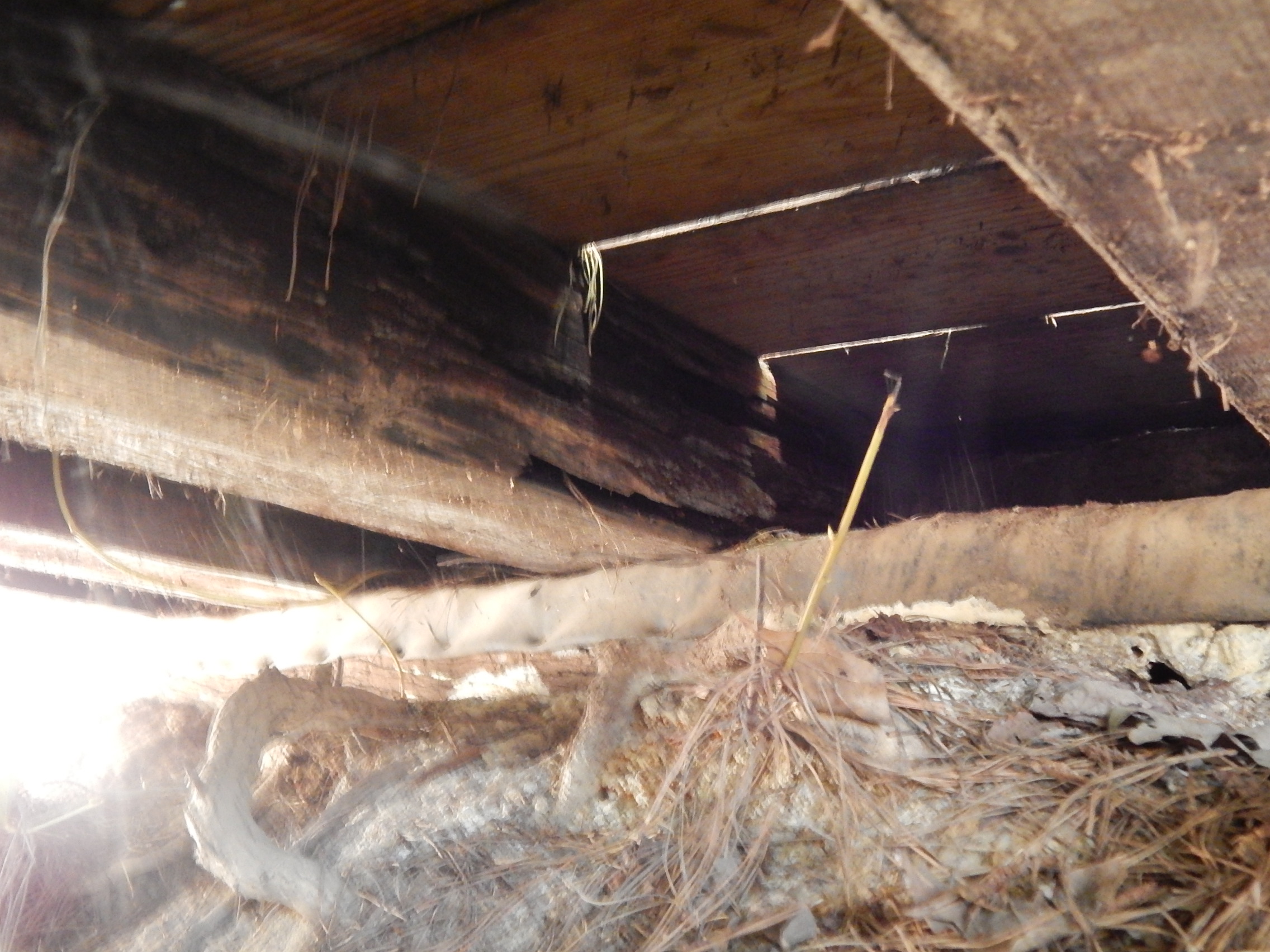

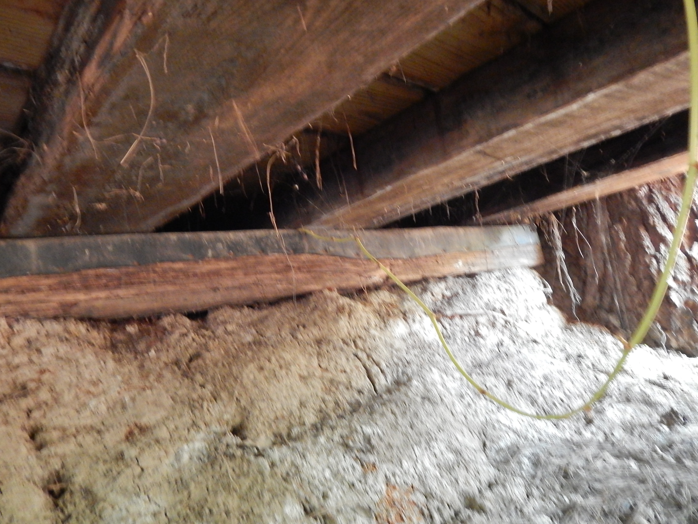

well I got motivated and just went out and this time crawled totally under the bridge.
Glad I did.
Good news and bad news.
Bad news is outside of several beams and cross footers definitely rotten, termites, who knows.
Good news is the beams under there are serious, almost a foot wide and at least six to eight inches thick. Big structural stuff, not anything at Lowes for sure. Screwdriver went in on the outside, but not on the inside.
But no question, lot of rot, but Mac, it might do it...
but that creek bed now looks a bit deeper.
So, this bridge was built for more than horses. But maybe not 57 of them...:rolleyes:

Those beams look like 12x12s to me. If they were intact, they'd handle the tractor just fine, provided the wheels were positioned over them. If the wheels are running on the boards but not over the beams, you might break through. And if the beams are Swiss cheese, then they could break just walking over them. 1 or 2 foot drop shouldn't be a problem if the bridge just breaks in two, just drive over it. However, if it powders or splinters under you that might be a problem if the drop is too great or the sides of the stream are too steep.

note in the second picture the right bank/side of the bridge had been repaired, probably when they put the new decking on, and they put lumber in there, almost looks wrapped in material like firehose. and look how badly rotted that big beam is there too...the part over the bank.
not 12x12 but I'm guessing 8x12. I would think four of them, in good condition, with proper planking, would carry quite a bit of weight.
next time I crawl under there I'll take a tape and do the measurements; i.e. how far apart the inner two beams are and if they might, by luck, line up. No matter what, with all that rot, unless I took core drillings of the things, would be hard for me to trust them.
I want to add to the "poking" info. On the sides of the beams, in some spots, went in an inch or two. In the center of the beam from the bottom, rock hard.

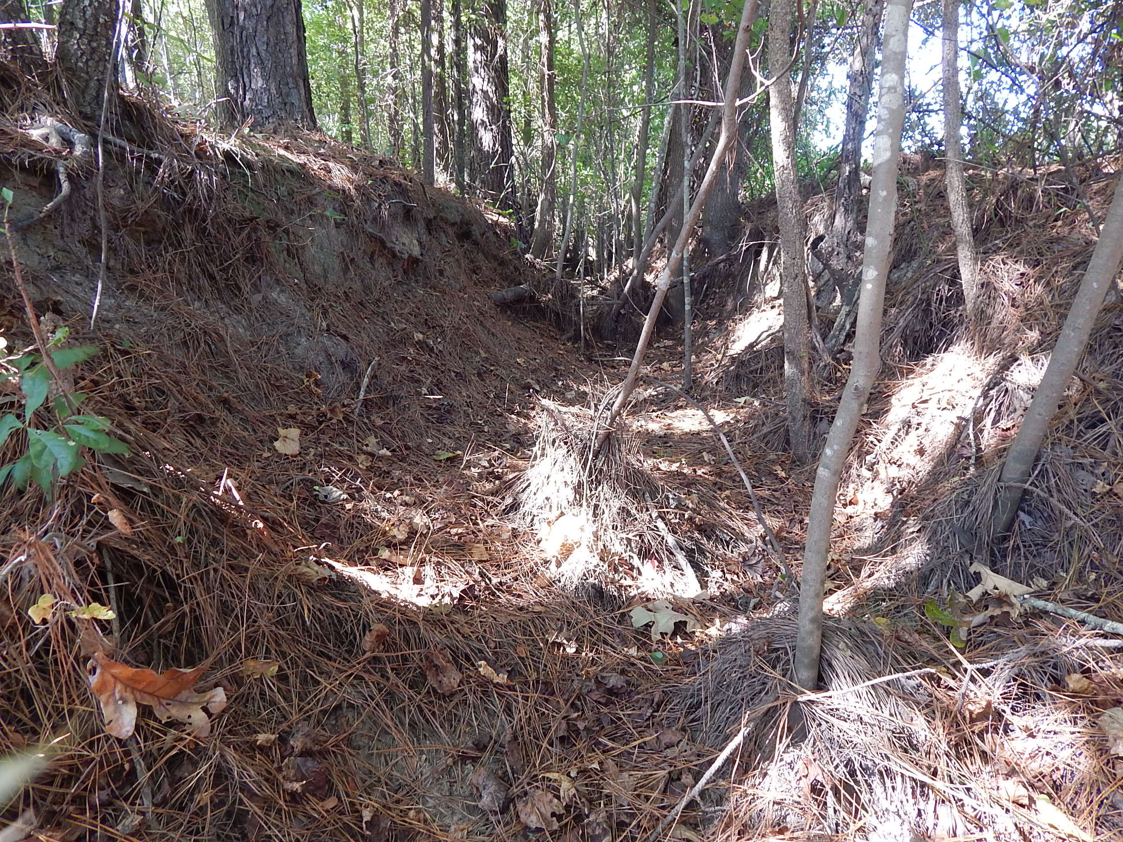

ok, back to reality. A twin tube culvert makes good sense, plug one, another at a lower level continues to flow.
No reason I could not dig this myself this winter, but I'd leave this little bridge alone then and just use it for the UTV and golf cart. Would probably do it on the right side of this bridge and actually, what really needs to be done is having some slavee hand dig the silt and muck out under this existing bridge, because it looks like the water would pool on the left side, water always going left to right.
