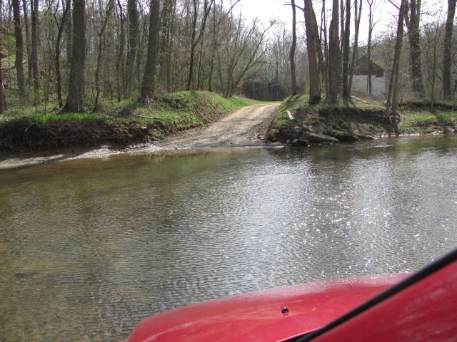

I've helped build wooden bridges on twp roads (many yrs ago). We used rough cut 2x12 oak as joists, double or triple under the main tire track area. Then nail oak 2x? across them for the decking. These were for small bridges the size of yours. We would drive nails with sledge hammers, sometimes drilling holes first for the nails. I know we took dump trucks across these wooden bridges. We also built them with steel I beams under the track area, then nail pt 2x4s on end across for decking, using metal clips that clip on the edge of the Ibeam, nailed to the wood.
I've got a small creek that I'd like to put a bridge across, but since I have a county road next to me, I just drive out on the road, cross their culvert across the creek, then enter my land again. Not worth it to build my own bridge. This little creek is always got running water, fed from "7 springs farm" on the other side of the road. my neighbor on the other side put a culvert across the creek, probably 24 or 30", and it has held up well with some heavy rains. Back on dad's farm we have a few farm roads thru creeks. Course we also have public roads thru creeks, here's one on a public twp road I went thru last year, water was almost a foot deep.
