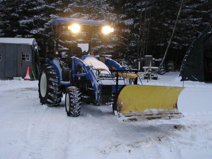

Mike,
This is exactly the reason I wanted a set of remotes and yes, I did run a set of lines from the rear of the tractor up to the front. They were made 14' which is a couple feet to long, but thats ok. There is always a way to tie back the excess.
To alter the FEL lines seemed to complicated for my simple mind. The rear remote allows me to operate a wood splitter etc. But it is mainly for the power angle on the snow plow.
All it requires now is to pick it up, lock the quick tach levers, hook up the 2 hydraulic lines and away I go.

Hi Mark,
Nice setup! Wish I had the quick attach FEL!
Just wondering though. With the blade so far out front, does it gouge when a wheel goes into a little rut or dip?
It seems to me that skids or wheels on the blade, plus setting the stick to the "float" position would allow it to follow contours perfectly. But then, I know nothing about snow plowing. /forums/images/graemlins/smile.gif

Jim,
I have reduced some of the photos taken at the welding shop. They will show better how the plows A frame is attached to the quick tach.
In this photo you can see the whole assembly. The upright piece is of course a tower from a Fisher Minute Mount plow. I obtained this from a local fisher dealer. It was a take off / throw away from a accident replacement. Freebee to me. /forums/images/graemlins/grin.gif

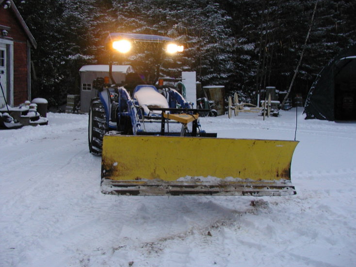

#27
Jason the welder, welded a piece of flat stock to the lower portion of the quick tach plat for strength and support. Then he used his plasma cutter to cut 4 ears / tabs to conform to the shape of the lower piece of the tower. These tabs stick out just far enough so that the plow can pivot or float on it's own when necessary. So when one of the front wheels drops the plow more or less stays it's course.
If I put the FEL into the float position, it allows the quick tach and the plows A frame to drop and drag on the ground. So I just lower things enough for the plow to make adequate contact with the ground.
I spent 2 hours this morning plowing out my yard and my neighbors (landlords Mom). The plow works slick.

/ How Sweeeet it is !!!
#28
Heres another angle of the Tower, A frame and it will give you a close look at the ears / tabs that the plow itself pins in to
