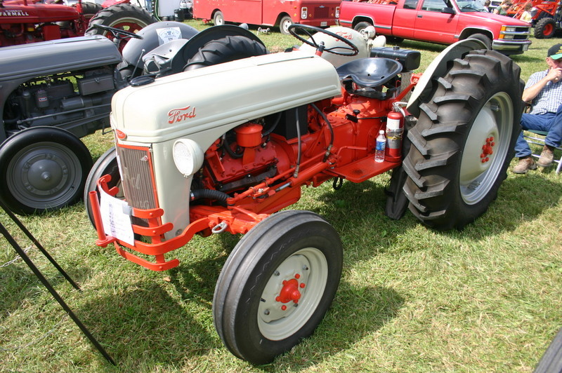

This optioned-out 8N is owned by a guy over in the next county from me. It's got a 60HP flathead V8, Sherman Combo auxiliary transmission, power steering, and a Howard gear reduction unit behind the transmission. The Howard was intended to be paired with the company's Rotovator (tiller) and slowed the 8N down enough to use this implement more effectively. View attachment 4417960
That's really neat; I've never seen an N with power steering before. Was it an aftermarket option available in the '50s, or was this a modern adaptation?
   / How the Ford 8N was customized with non-tractor engines #34
Power steering, there were some home brew developed PS but nothing I am aware of as being commercially sold other than the "Jackson Power Steering" which came well after the 50's. In the 50's power steering was always by "arm strong"
