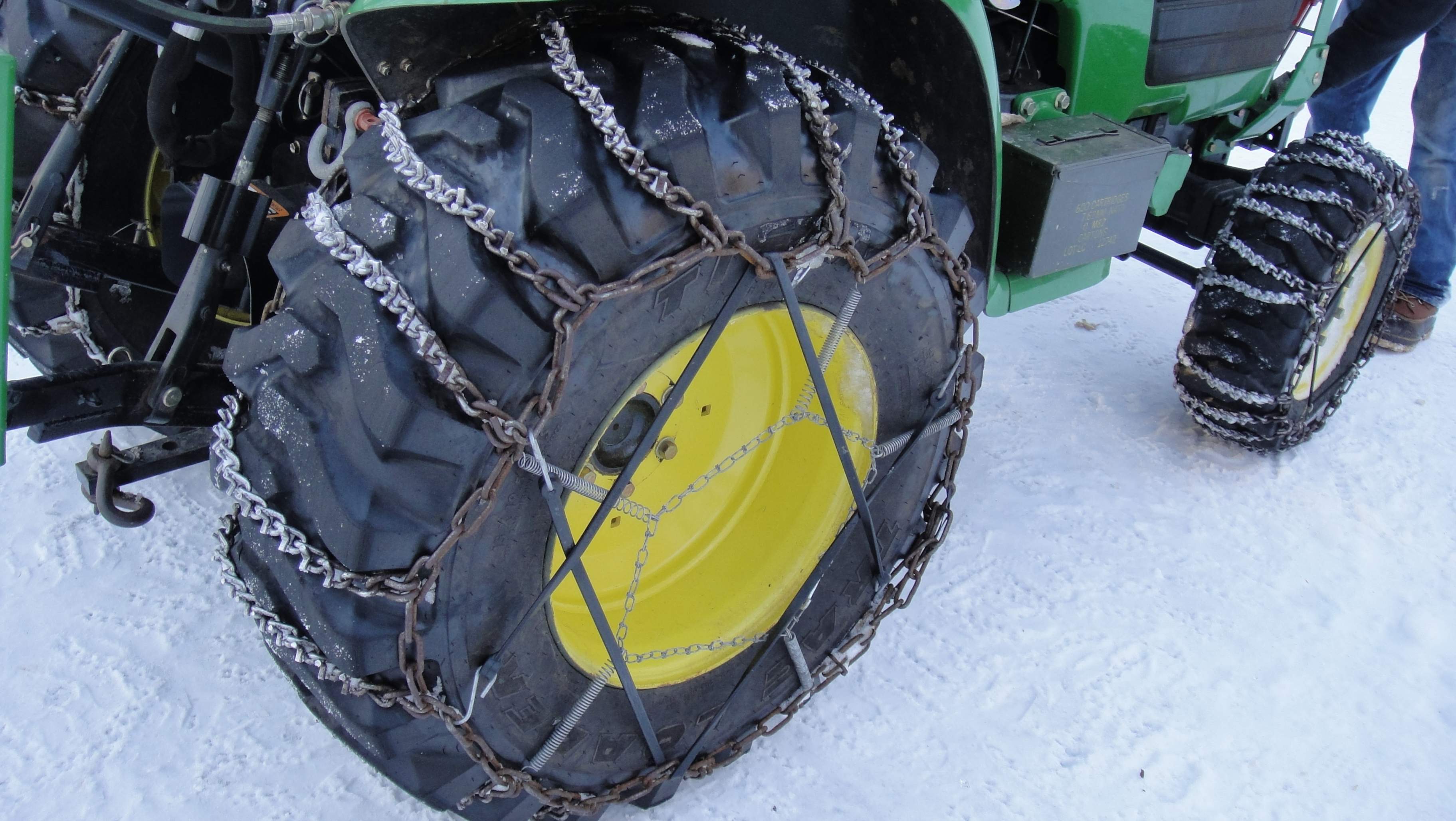

You will get both sides of the equation, some like them loose. I am at the other extreme, I make them as tight as possible, even the extra loose links I zip tie so you can't here any loose chain.
Some say you don't need tensioners, I don't agree and use at least 4 point slack take up between the side chain.

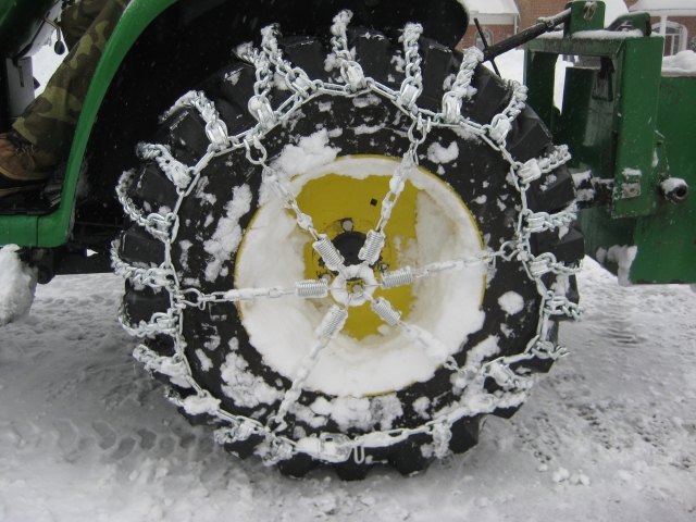

I put mine on as tight as I can get them. Then I drive around a bit and tighten them again. As long as the spring tensioners stay tight from that point, I'm happy.

I followed tirechains.com video and mine are very tight...no slack at all. I also use spring binders. They work GREAT
