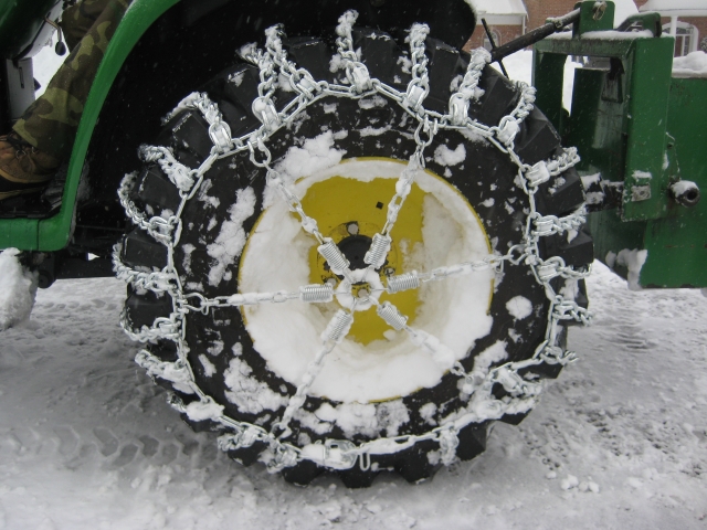

When I first bought my 3320...due to the lack of clearance, I installed screw-in studs in lieu of chains for icy conditions....once I installed my wheel spacers this summer I was able to install chains....my chains of choice (since the 70's) have always been from Canadian Chains in Skowhegan, Maine Canadian Chains [Home] Of course, the fact that they are only about an 1.5 hour drive from here means there is no shipping cost..just the pleasant drive across Rte 2 ....and I agree with what appears to be the general consensus..the tighter the better (just ignore the cursing while they are being installed)
Them are some good looking chains, mine just go straight across my tread pattern... that would probably explain my bumpy ride... I would have liked to had a set like yours!
