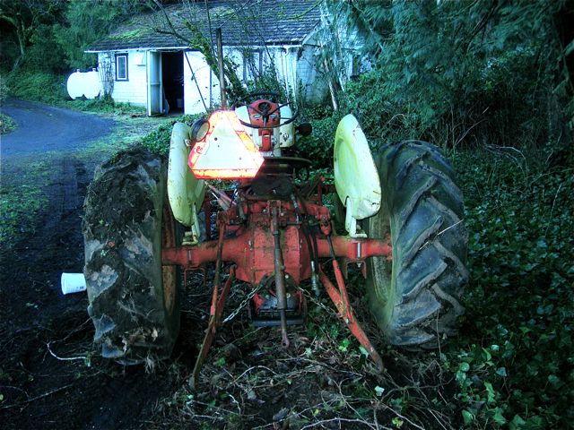

You mean like these two chains on the back of my '62 Ford 881? They definitely do keep implements and the lower arms from hitting the rear tires, but they don't really check a load from swinging in about a 3-4 ft arc. . . . As mentioned above I don't have the stabilizer bar that was meant to keep things lined up with the rear of the tractor.

That is what mine has. The stabilizer is a flat bar that attachs to the underside of the right fender mount. There should be a stout piece of angle with a standard 7/8 pin (same as implement size) but shorter.

Here is the pic of my Ford 2000 stabilizer. The stabilizer bar is shaped like a hockey stick so that it does not hit the axle then the hitch is raised.

There is only one used, you don't have one on the left side.
The tractor end of the stabilizer pin is aligned with the drag link pin so raising or lowering will not cause any lateral movement of your implement.
I use it for hoggin' and i would use it for a tiller. I think the only attachment I don't use if for is plows (really ground engaging). Rear blade, snowblower, cultivator, hog, ditching bucket all use the stabilizer.
