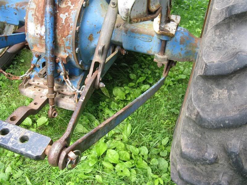

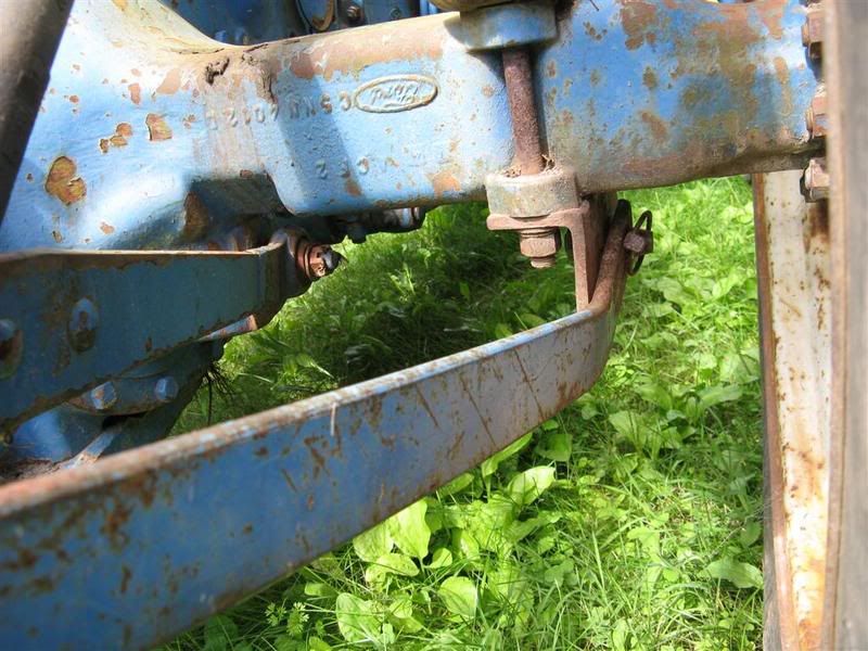

Here is the pic of my Ford 2000 stabilizer. The stabilizer bar is shaped like a hockey stick so that it does not hit the axle then the hitch is raised.
Cheers,
Mike

There is only one used, you don't have one on the left side.
The tractor end of the stabilizer pin is aligned with the drag link pin so raising or lowering will not cause any lateral movement of your implement.
I use it for hoggin' and i would use it for a tiller. I think the only attachment I don't use if for is plows (really ground engaging). Rear blade, snowblower, cultivator, hog, ditching bucket all use the stabilizer.
