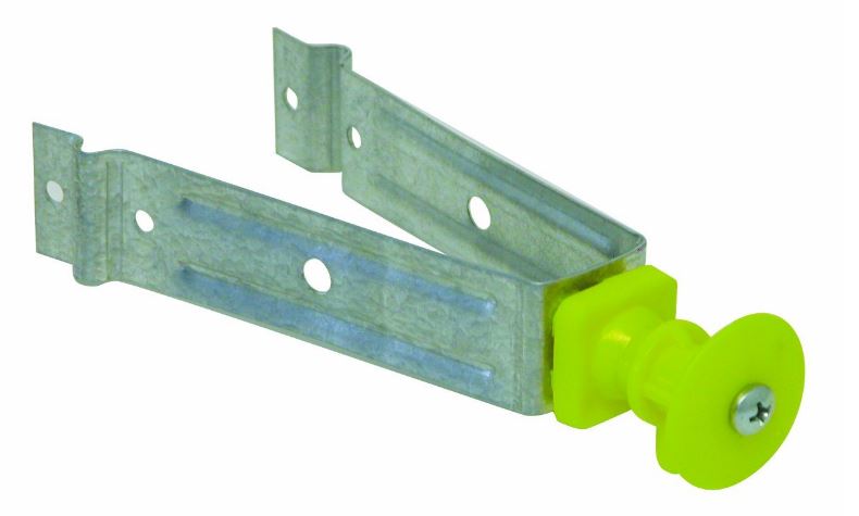

Tension your fence first, then add electric. Just turn the insulator in your pic upwards and hold it on with a couple of zip ties or twisted wire. I'd suggest electric tape wire instead of steel wire (personal preference).
Amazon has many insulator types, different lengths.
This one could be pipe clamped, drill the post and screw/nut, twist wired on.
Amazon.com: Field Guardian Chain Link Extension Insulator, 4.5-Inch: Pet Supplies
Snow always causes wires to sag- 2 inches may not work well for winter. Steel will sag too because it will pull the insulators out of position with the weight (ice storms).
A general comment about insulators, not to say anything about those particular choices:
You want your electric fence to be reliable. The nature of it is that if it shorts or has a break the whole thing fails. And this usually happens in the middle of a winter storm when either ice builds up on the wire or a branch falls on the fence. In my experience, insulators are the weak link. Pieces that clip on can come unclipped. Anything made of plastic will degrade in the sunlight, get brittle, and crack. I find that black plastics tend to be the most durable outdoors. I've had a lot of failures of yellow plastic insulators after a couple of years. Porcelain is the gold standard for crucial components. I prefer insulators that bolt on, screw on, or nail on to ones that clip on.
Amazon is great for getting a good price and quick shipping if you already know what you want. However, a lot of what they sell is cheap and not durable. I find that a dedicated fence retailer like Kencove is more likely to sell stuff that works. Even at Kencove I've had so-so results shopping their clearance section, I think they discontinue stuff when they get a lot of complaints and then put it on clearance.
For a 400 foot fence you only have about 40 insulators, it's worth spending a little more and doing it once.

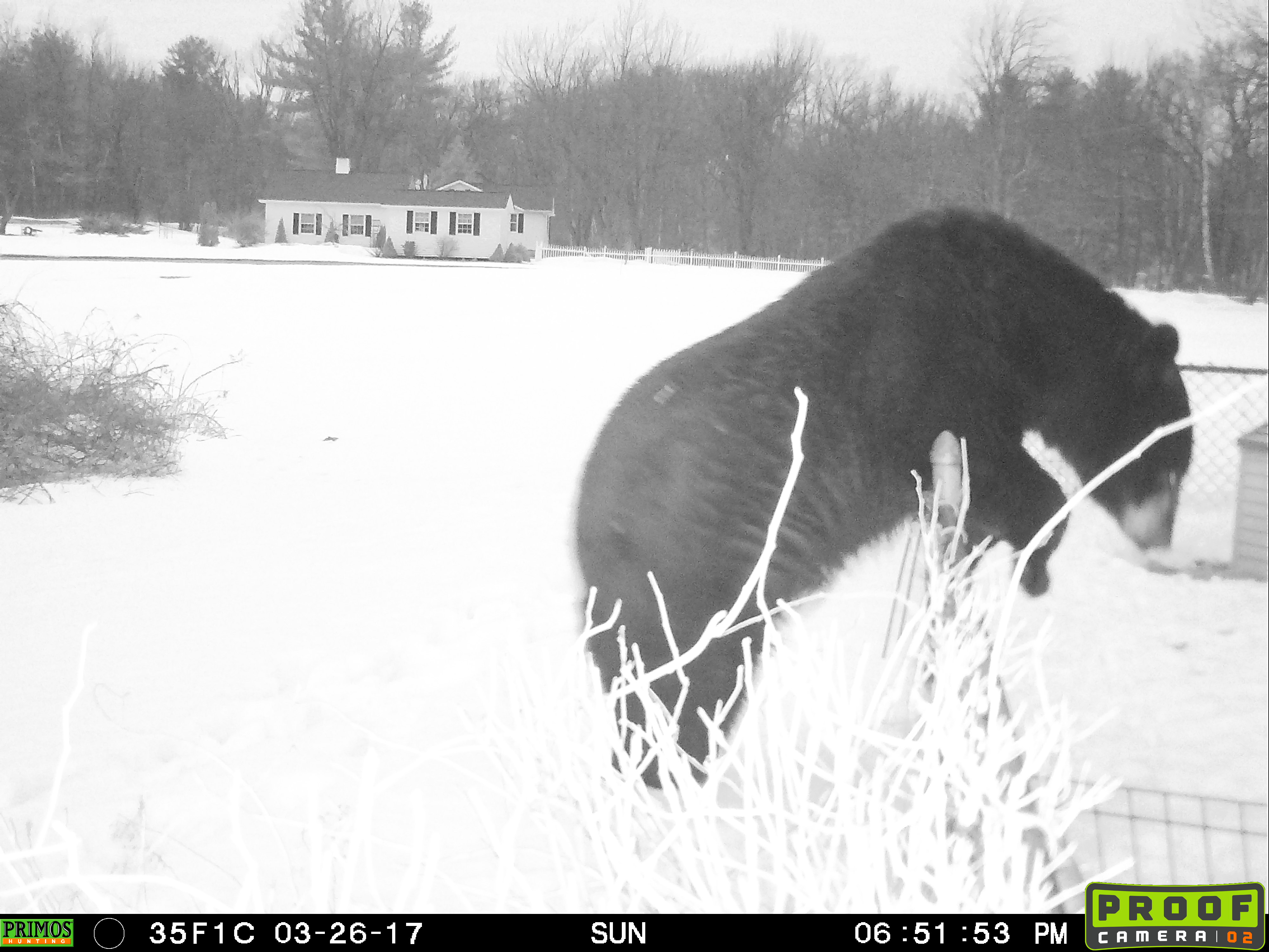

I am adding the hot wire to keep the bears out of the dog area. I have a large male that lives in the woods behind my house, and comes to visit on a regular basis.
Took these pics last year. He is climbing over my current fence which is 30" high.The new fence will by 48" high and fence in a much larger area. The new fence is using larger diameter and thicker line posts, terminal posts and top rail to increase the strength.
I have several hundred feet of Premier 1 48" high net fence protecting my chickens and ducks, and I know for a fact the net fence keeps the bear out of the chicken yard. I use a 1 joule charger and the net fence registers 8000V+. I have warnings signs posted all along the fence, and I warn all visitors and guests before we go to see the chickens, ducks or the pond. I wanted something more permanent and nicer looking for the dogs and back yard.
