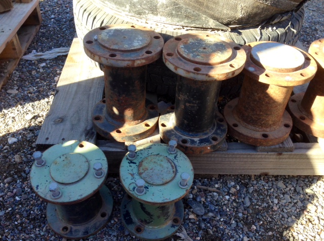

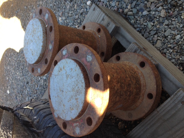

I think I have what you need. These came over from Japan years ago on Yanmar's that either had duals or just had really wide spacing. I don't remember. But in any case, we narrowed them up. I have 3 pairs, all a little different. 2 are for rears, one set is for fronts. I suppose you could use these to install duals, but if you want them hub-centric, they would have to be used as spacers only. But then again, you'll probably keep the Yanmar under 60 mph anyway....I'm having problems uploading images, so I am not sure if the pictures will display. If not and you want to see them, PM me with your email. Thanks.

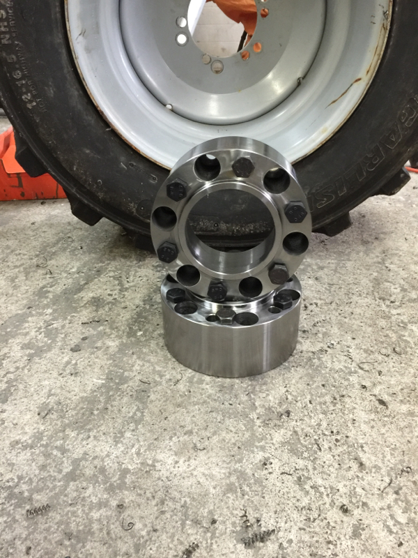

Here is a set of 3" spacers I made up for the dealer here. The axle on smaller tractors are not built for the loads of dual tires. I added Calcium to my fathers 2516 Mahindra and it also made a huge difference to the stability.
