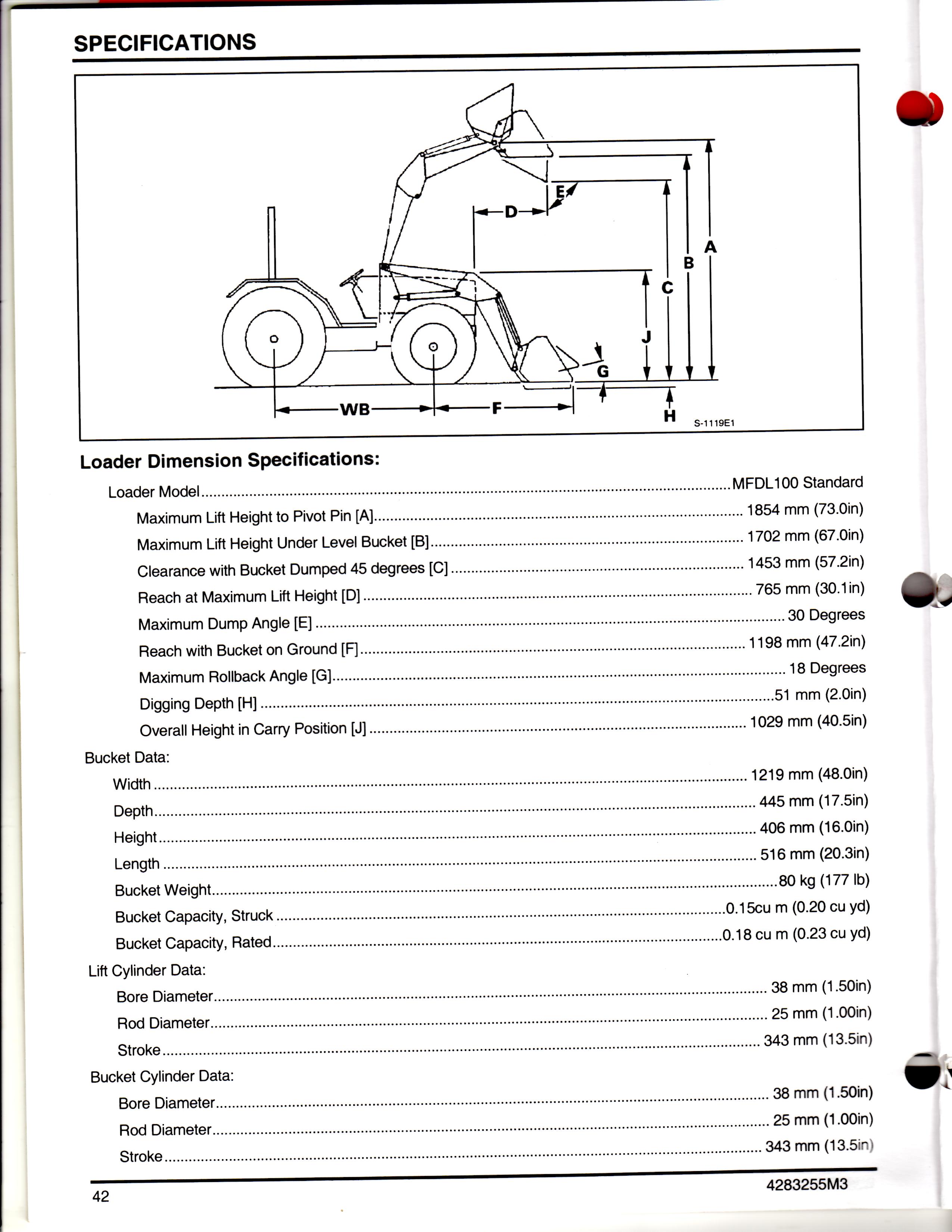

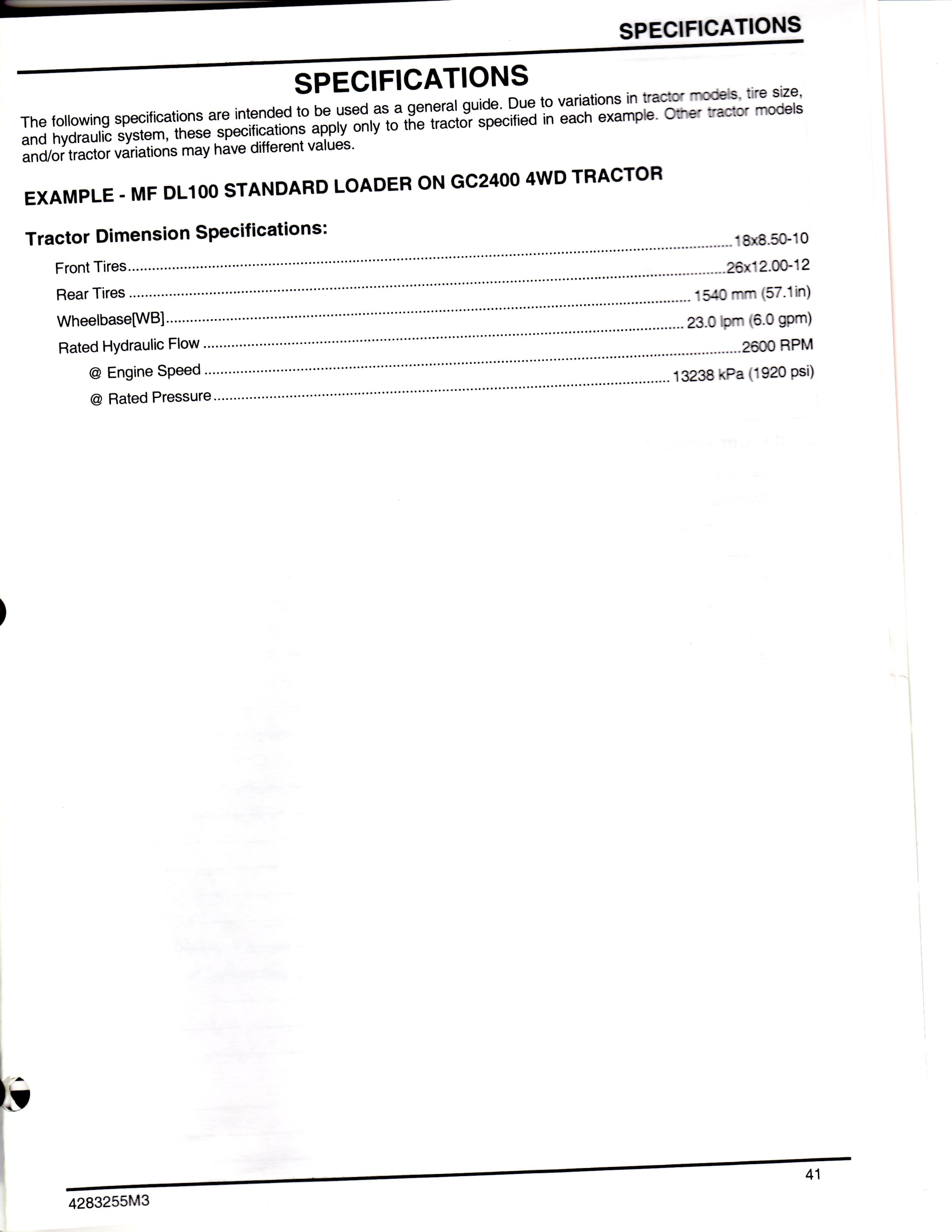

jist got got a 2010 GC2400 with DL100 (255 hours on it) that seems a bit low on lift power. granted I am more used to a 2017 GC1710 DL95 but this DL100 struggles more than what the spec differences themselves cause. I am having breakout issues with 250lbs (3/4 bucket) of loam.
system operates smoothly no odd noises/etc just little less force than should be.
am unable to find out pressure specs for the GC2400 / DL100 combo and on kenny site am unable to tell for sure what the fitting would be.
any advice appreciated
Dmacleo, welcome to TBN and congrats on your tractor.
Here are the 3 pages of "Specifications" from my 2009 MF GC2410 Owners Manual that may help you.
KC
   / HOW TO: Adjust the Pressure Relief Valve (PRV) on the MF GC 1705/10/15/20 #93
LOL I had forgotten to look at my owners manual for pressure spec, for some reason thought that would have been in a service manual.
yup 1910 is what I need to shoot for.
