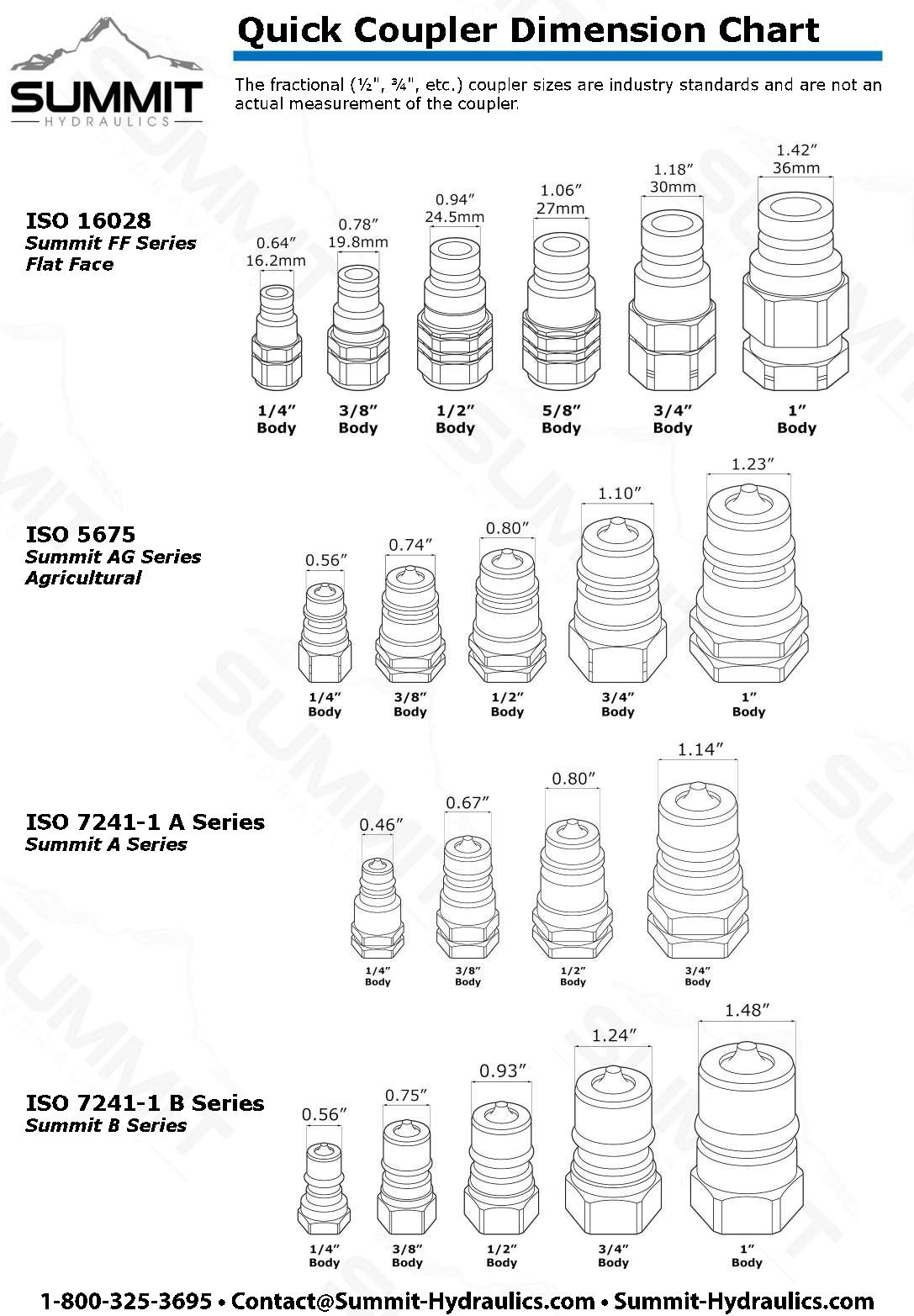

I'm sorry for trying to help....the chart is not "mine", I was just proving it as a reference to the info-notice that it's from DHH. Most won't even read the charts or the FAQ's, you think they'll read or understand a disclaimer about a ball vs. a poppet?
I also can't help that OEM's change things or pick oddball couplers to use on their machines...Good day all, I'm out.
Well you're linking it on your website and referring customers to it, so...that chart is "yours" enough methinks.

On my DL 95 loader on 2017 GC 1715...
Probably is ISO 5675, which is "0.56 in" ( 1/4 inch) by direct measurement...
ON female body it states its a Safeway S45-2 which is 1/4 inch....
https://www.safewayhyd.com/wp-content/uploads/2019/04/Safeway-Catalog-2018-2627-S40-Series.pdf
WHICH makes the "Bolt on Hooks" chart correct for my application...
Dale

Your chart and link should help folks out, and those that have 1/4" couplers should have couplers the same as I have...
On my GC2410, which has the FEL- Model DL100, here are the couplers that I had researched years ago and purchased:
All are Safeway; S40 Series, 1/4" Body, 3000# @ 3 GPM
S40-2 is a "complete coupler" (female & male)
S45-2 is a "female half"
S41-2 is a "male half"
And I purchased Loctite Sealant 545 for the installation.
KC

Ok, I'm seeing a pattern with the Safeway couplers, I guess they're following numbering which is fairly common with fluid power fittings. In Sxx-2, the number 2 seems to indicate that it's a 1/4" npt fitting. Mine is a S45-3, 3 meaning it's a 3/8" npt. If it was a 4 it would be 1/2" npt.

I work with pneumatics for a living with the fittings and all that, different game but same ballpark as hydraulics.
   / HOW TO: Adjust the Pressure Relief Valve (PRV) on the MF GC 1705/10/15/20 #88
:cool2:
Safeway does it kind of different than other companies like Gates or Eaton. 1/4" in Gates is a #4, 3/8 #6, 1/2 #8 and so on.
Any local industrial/hydraulic supply place should be able to hook anyone up with the fittings needed. They are usually so well versed in their field, you can take a picture of what you need with you phone and they can get you on your way.
