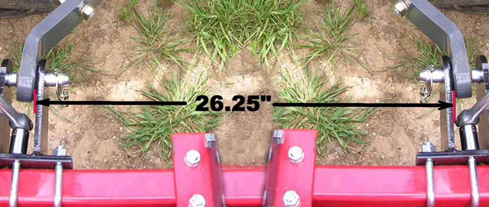

That A L2800/3400 you got there?
Set your spacing at 26" inside measurment and enjoy . Since this is your first time to run the tiller did you adjust the PTO shaft length accordingly if it needed it?

Thanks wushaw...I will adjust to 26". I had read elsewhere that the PTO shaft on new tillers may have to be cut down if they are to long....so that was one of the first things I checked on mine. Luckily it seems to be fine. I ran several passes through the garden plot and the only trouble I noticed was the turnbuckles dragging. I think we will be good to go after the adjustments.

Sorry...I forgot to mention that its an L2800

Ground engageing thing you want a little free play,,maybe an inch side to side,,or you'll break something,,center it and adjust so you got an even amount of the inch or so free play,,[it generally gets tighter as you lower and thats where you need the free play,,lowered],,,thingy

Here is where to measure and then adjust your sway links to where you have about an inch of free play. Where the tiller will sway back and forth about an inch.

I have an L3400 which has the same setup on the 3PH as you. With standard Cat 1 implements and R4 tires there is only about 1.5 to 2 inches between the turnbuckles and the tires. Adjust the turnbuckles to where there is just a little movement and tighten those lock nuts. Use a wrench or screwdriver to hold the turnbuckles and tighten the nuts tight or they will come loose and the turnbuckles will rub the tires. Do not remove the check chains.
