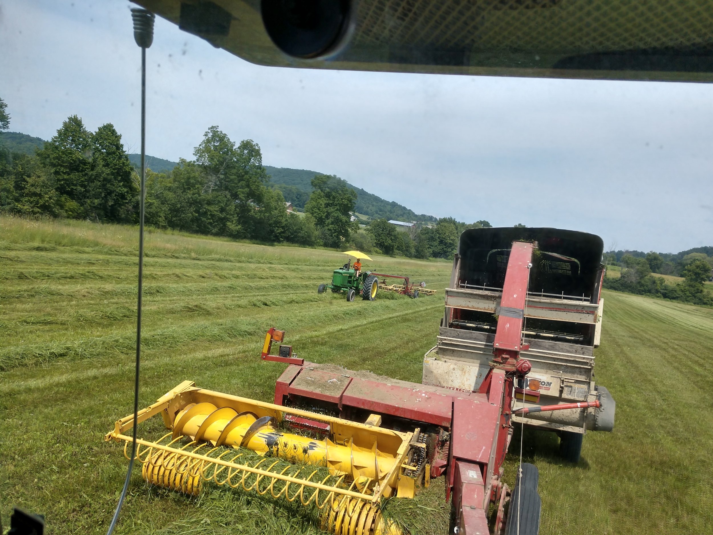

It is quite doable it is not real easy but not bad with practice, that said. Do NOT try and eliminate that axle pivot unless you like to break things.
I am hoping you are attaching to the fixed drawbar on your tractor, if trying to use a sloppy floppy bar in the 3 point you are making it even harder to backup.
If you want to make it a bit harder try this setup.
This double rake is even worse
