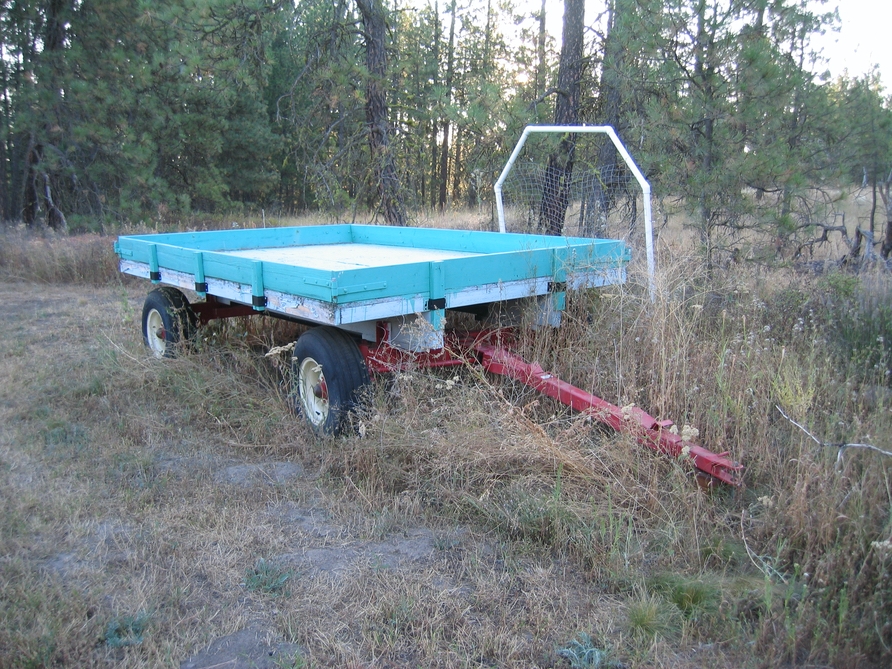

I just got an utility trailer with two axles. The front axle pivots.
The tongue is A-Frame. It looks just like the photo attached.
While I am normally pretty good at backing up trailers -without pivoting axles- I find this one is just about impossible to back up. I don't know if it's because the tongue is too short or if it is the double pivot point that screws me up.
So for those of you whom own one of these how do you back them up?
Do I need to lengthen the tongue?DO I need to rig it so I can tie the 3-points lower arms to the tongue or do I need to fit something to lock the tongue at the 0 degree position when backing up?
Thanks in advance.
Independent rear brakes are your steering help when trying to back up a wagon. Learned at 12 years old working on a vegetable farm backing them multiple times daily up To a loading dock with other tractor/wagons alongsid. A knob (suicide knob) bolted onto the steer wheel helps immensely too. So unlock them rear whee brakes and give it a try.

Boy sorry you got all those stupid reports, some where nice. Rule one when backing up a four wheel wagon it responses quickly to the action of the pushing vehicle, rule two what ever direction the front vehicle is pointing or turning too is going to copy but quickly, rule 3 slowly or make little gentle moves, Rule four good luck and be patent it will come to you more you do it. I can back up hay baler and hay wagon at the same time and put the hay wagon where I want it but each year have to get back into it all over again. lol after the first wagon it gets easy again so its not something that stays in you easy it is something if you did it weekly it would be easy. Hope this helps be easier to show and demonstrate

I already figured that it goes reverse as a normal trailer but I still cant get it to back up properly.
Would lengthening the tongue make it easier?
Or any of the other possibilities I mentioned eliminating one of the two pivot points i.e. either pinning the axle so it does not rotate when backing up or braising the tongue (using the 3-point arms) so the hitch does not pivot?
First, stop using the 3 pt drawbar for pulling trailers, there is mo down pressure on the 3ph other than the tongue weight. It is a good way to get into trouble. Use the fixed drawbar attached to the under belly of the transaxle—this can not raise up.
Second find an opened area and get some flags—the ones on a thin wire. Then practice practice practice. Then practice some more. You must think in a different way from backing up a trailer when backing up a wagon.

Because if he doesn't have a practical use for that wagon such as hay ride, hay wagon , corn wagon ,etc, he will be much better off IMO with a regular trailer. I hope he comes back and let's us know what he plans on using it for and depending on what he says it might change my mind, most farm folks around here try to figure out how not to hook up to a wagon with a tongue on it, especially behind a pickup.
The wagon is 5 ton capacity with air brakes and dumping. I planned on using it mostly for moving excavation material from A to B on my property.
I will give it some practice but the solution might be to sell it and get a trailer instead of a wagon.

Well around a corner is not an issue because so far all I can manage is pivot the axle to about 90 degrees as soon as I start turning...around a specific corner though would be a different story...
Some wagons can be a little tougher to back and get it to turn and go exactly where you want it to, straight back not as bad but backing some of them around tight corners in a timely manner not so much, there are apparently many on here who can thread a needle with one, but not most of us, so don't feel bad. :D
