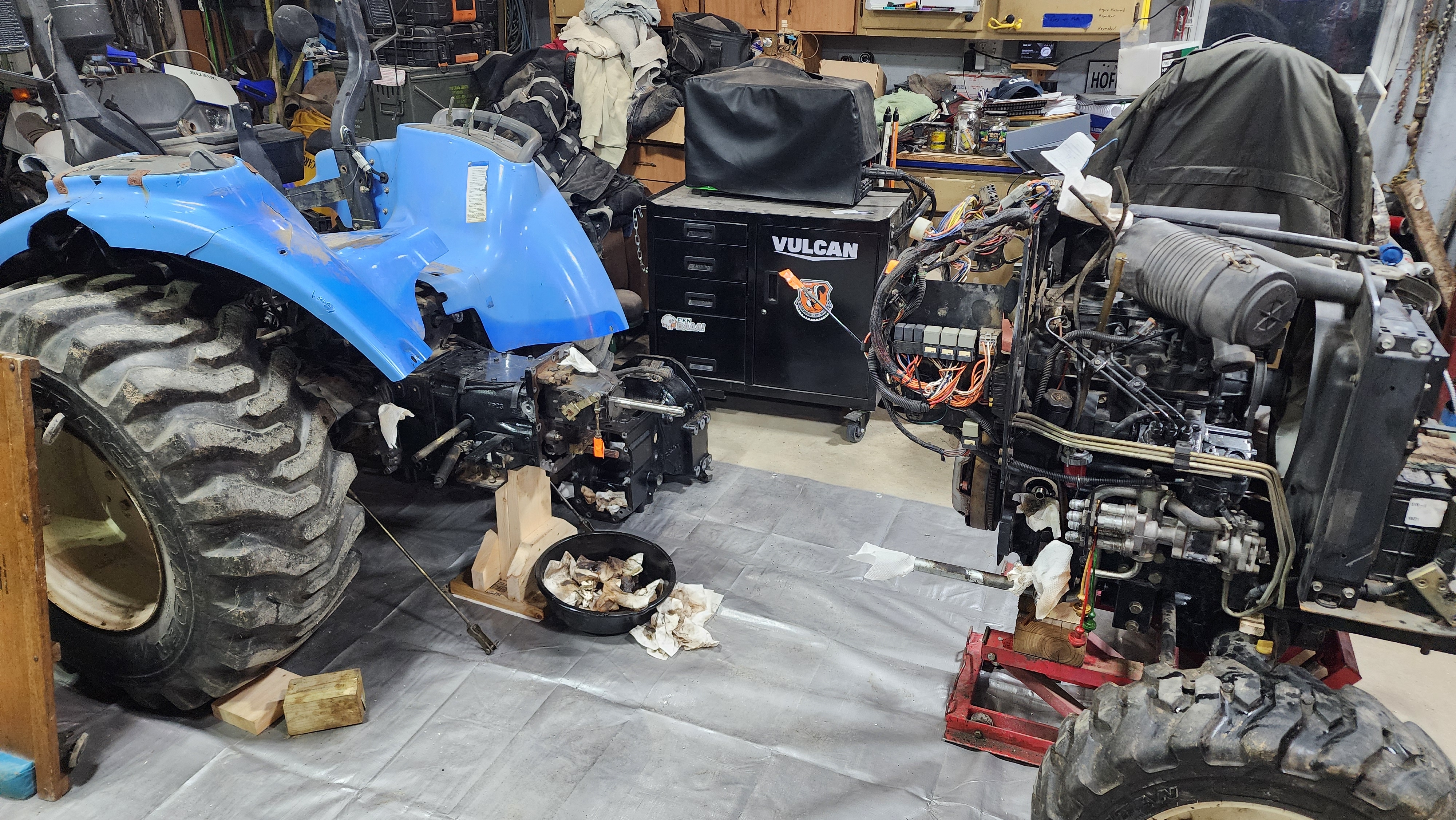

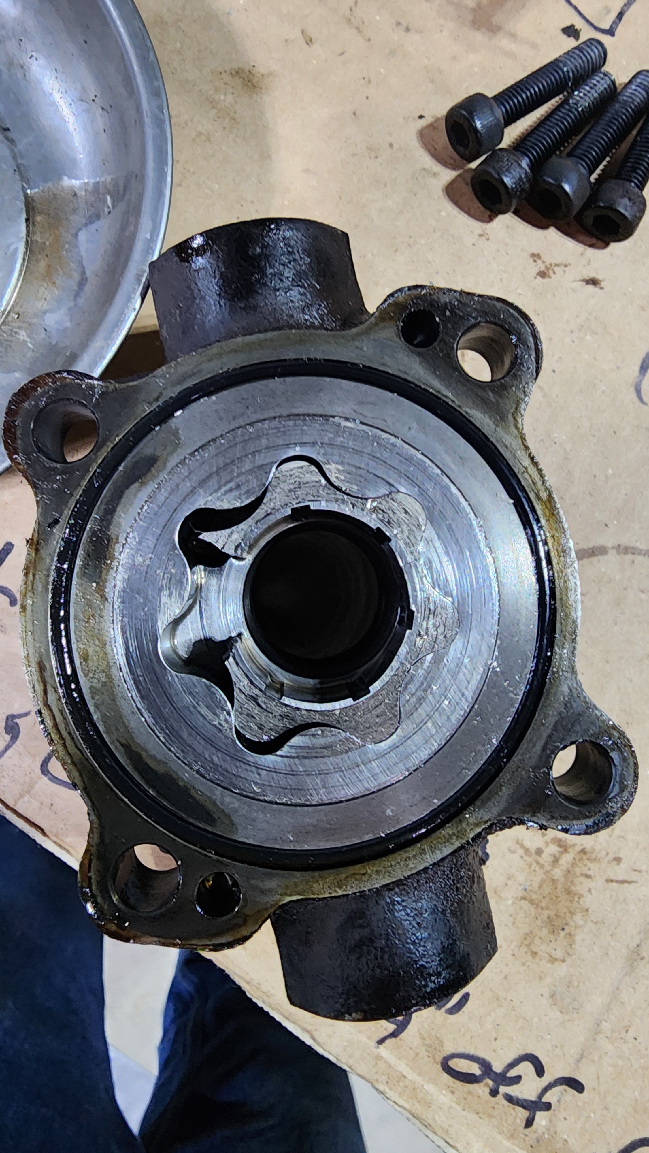

#15
On a positive note, I tore it down two hours quicker than last time.
Another positive, I found the issue.
A negative, I'm gonna have to up my game on my only fans page. :/

   / How to bleed T2220 HST system? #16
Wow! No wonder it won't pump. You didn't do that damage during your repairs, must have been some side thrust going on with the engine running while the case was busted. How deep do you plan to go? That shrapnel must have gone through the rotating groups as well.
Just my two cents.
   / How to bleed T2220 HST system? #17
With luck the charge filter stopped the vast majority of the shrapnel from reaching the main HST components.
Running the tractor after reassembly without charge pressure may have done some damage to the HST pump wear surfaces since there may have been a limited hydrodynamic bearing lube on these surfaces after sitting for several weeks.
   / How to bleed T2220 HST system? #18
I'm still not clear on all the details. The case broke, so both halves of the tractor are no longer aligned. How long did the engine run at this point? Was the hydrostat still moving the tractor at this point? Did the tractor quit moving after that? What all was done to get the tractor in the shop? Was it running during any of that? When it was taken apart what did the oil look like in the line from filter to hydrostat? Any or all of that could have bearing on what the inside of the hydrostat might look like now.
   / How to bleed T2220 HST system? #19
Harry
The way I understand the sequence of events happening.
1) some load shock broke the bell housing and tractor is still running.
1a) I am not clear on if load was removed from loader at this time
2) tractor is driven under its own power approximately 150 ft. This is possible even without working charge pump since the “closed loop” between HST pump and motor is already filled with oil. NOTE: this is based on mechanical control of the swash plate.
My suspicion is like yours the housing broke causing either thrust or side load on the charge pump causing it to seize. Once it seized there would be little to no debris movement from charge area to the main HST which might have saved the HST from catastrophic damage
This is unknown until HST pump is opened for inspection
   / How to bleed T2220 HST system? #20
When I look at the posted photo of the charge pump it's obvious it didn't seize immediately. The scoring, cracked and missing pieces didn't happen AFTER it seized. It was probably still pumping something while gradually tapering off in that regard. And are we sure it actually did seize? As ugly as it is, it may still have been turning, just not moving any oil. After sitting idle for the time the tractor was apart, draining and drying out, it's no wonder it wouldn't pick up prime, whether turning or not.
