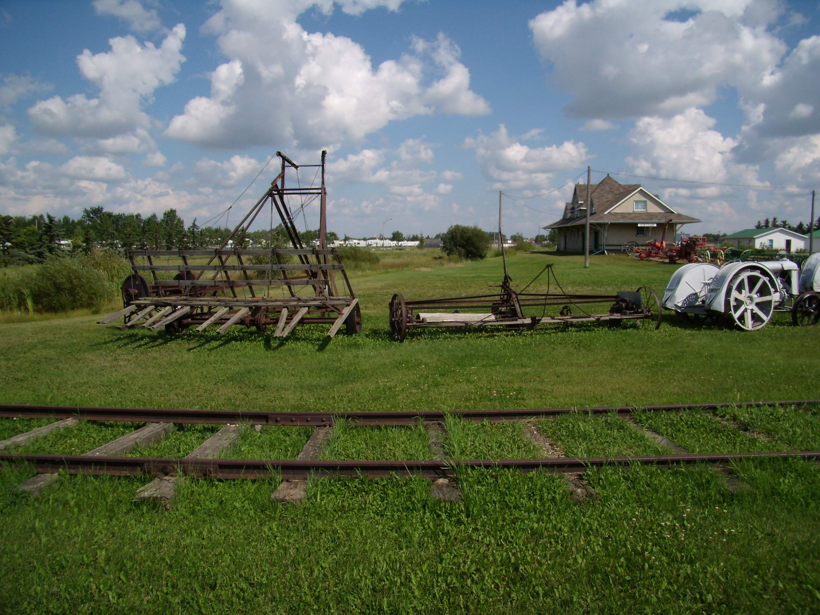

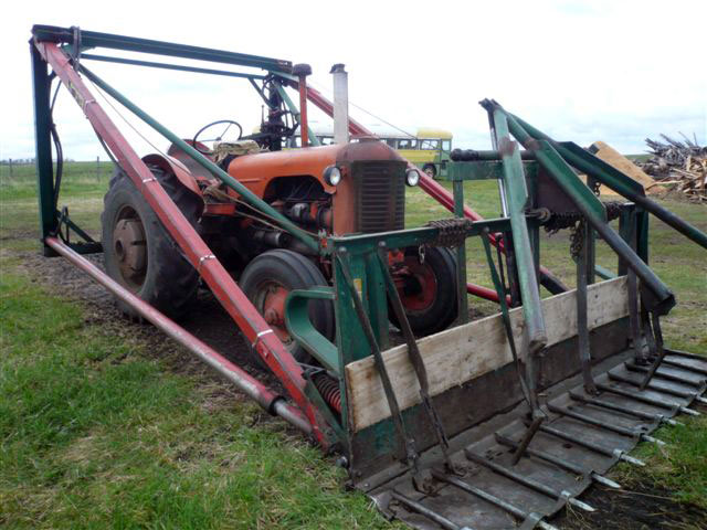

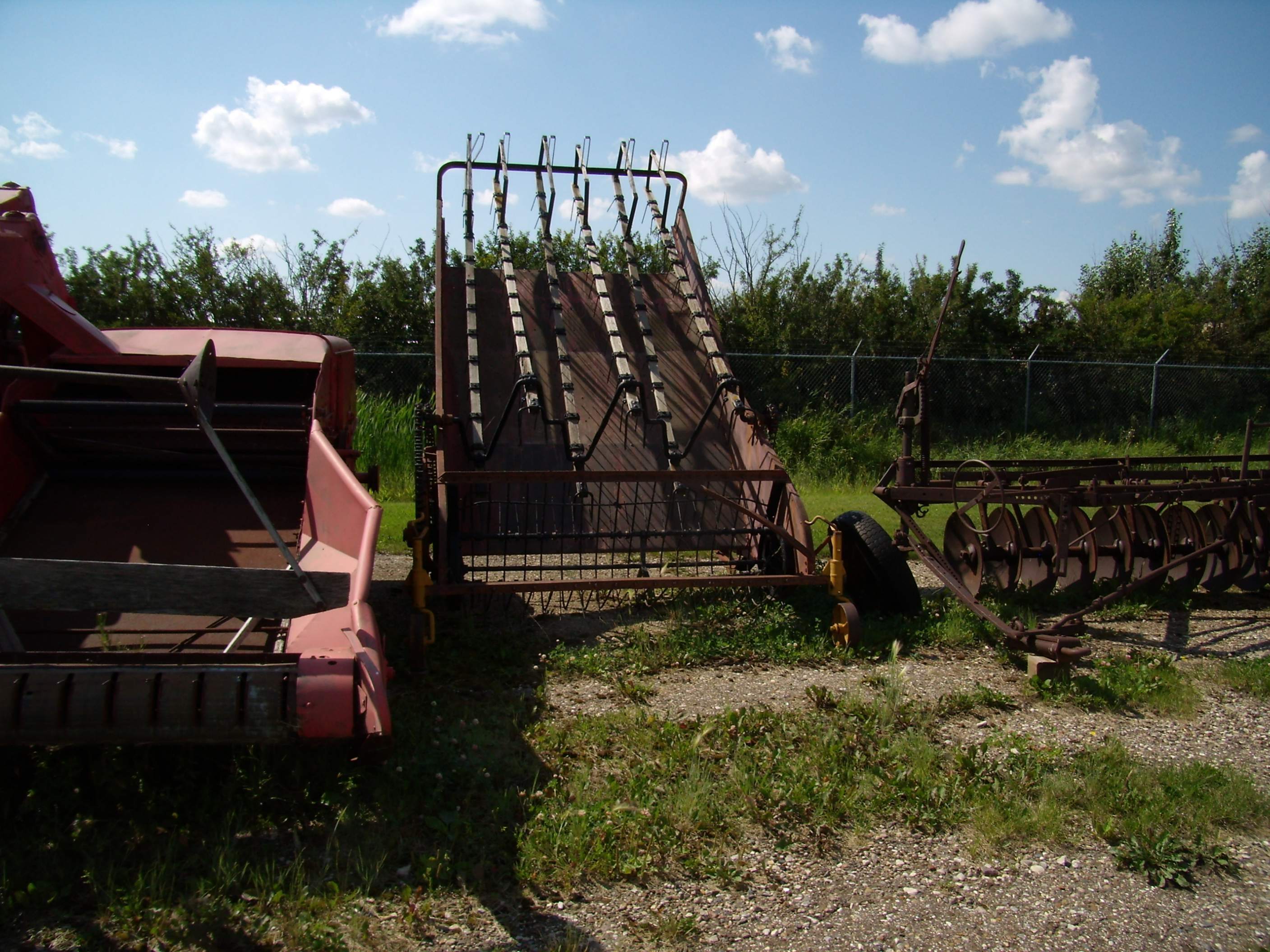

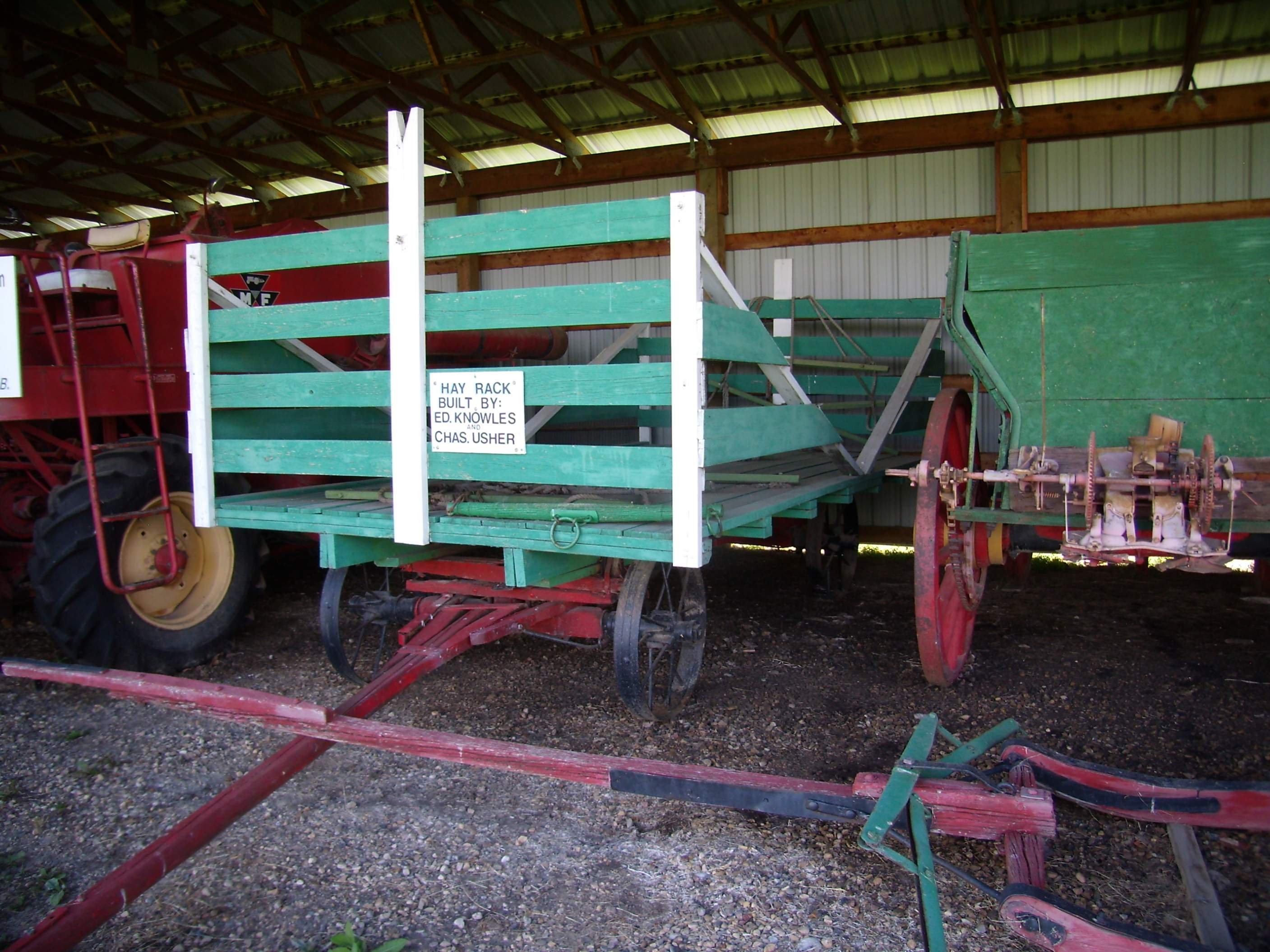

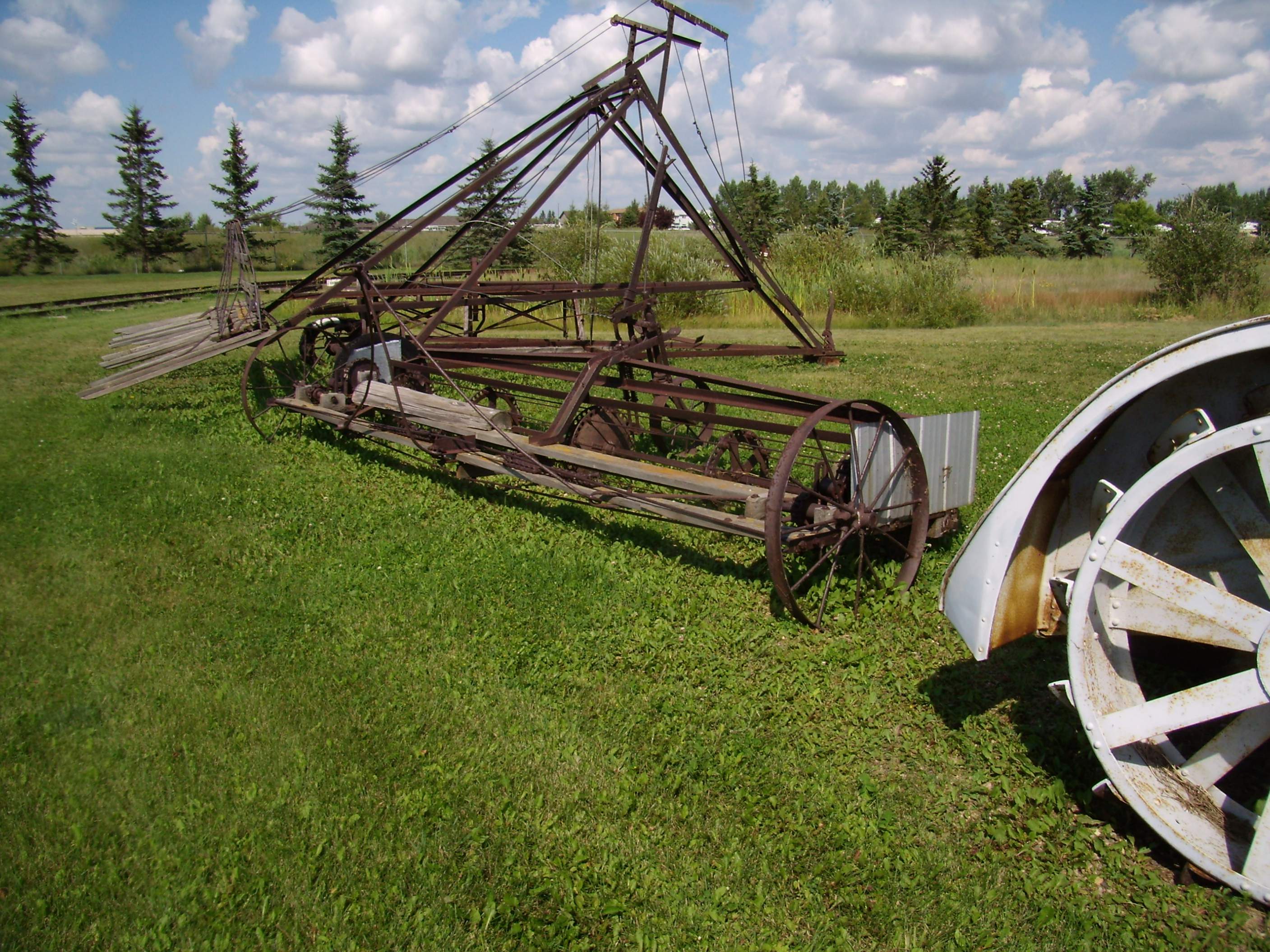

At one time the area I grew up in used what was called a tractor mounted Farmhand and Stack movers to handle hay.:):) farm hand.jpgP8120040.jpgP8120070.jpgP8120037.jpgP8120031.jpgP8120030.jpgP8120041.jpg

Pictures are from the Stettler Alberta Museum.
