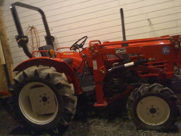

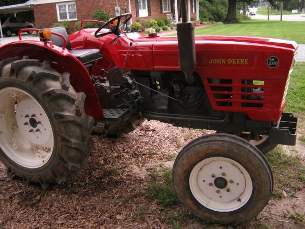

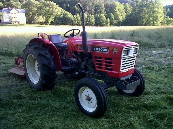

Well it sure is nice to have an active owner community to get advice from and I really appreciate the responses. I certainly feel better armed to make a decision. Let me summarize what I understand so far and show the three currently on my list. Additional comments appreciated then I'll leave y'all alone!

4) The V2A loader on tractor #3 and 46 hours on the clock are a good indication of a VM recon

Tractor #1 (3110) was sold by a local dealer to his friend 4 years ago. Friend had 2 other tractors (JDs) at the time. The old guy got sick and is selling off his equipment as he needs the dough and is too old to garden. The original dealer is helping the old guy sell the equipment and he is who I am dealing with. He said he used to get a truck load of Yanmars periodically for local resale and moved "hundreds" of them. He told me he still has the original invoice where he sold the tractor to his friend for $5800 dollars. The friend supposedly used the tractor to till his garden. Not many hours added by the old guy apparently but I don't know what the clock shows.
Asking $5300
Tractor #2 (3000) was bought from a dealer, tractorsonthecreek.com in western NC. Used a couple of years for mowing. Owner seemed very forthright. Mentioned the tractor's 3 point was "sensitive" and less than responsive when cold. 160 hours.
Asking $4200
Tractor #3 (2610D) was bought from the same western NC dealer as tractor #2. The guy's story of needing to sell to fix his truck does at least sound feasible as he also posted it in the "barter" section of CL and was willing to trade for an F250 diesel. But people will often talk out of non-standard orifices to sell something and I realize that:
Asking $8000

I like the 2610D it has a v3a btw its a quick detach bucket and is self leveling (how that works is beyond me but it is what it is) you will have to make your attachments as I am not aware of there being anything available. I am concerned with the 3110 it looks to me by that pic anyway like it only has 2 injector lines like a YM 2000 but it is a powershift and appears to be the correct chassis elifino whats really there pic is deceiving to me?! (3110 is a 3 cyl model)
   / How to by a used Yanmar #14
Good catch Cardoc. I would have gone for the first one, but after cardocs catch i think that is a 2210, which is a 2cy tractor. I think the 3110 is a bigger frame tractor too, ask the first seller how big the rear tires are. This will tell us. The 2210 should have 9.5x24 tires on it. Also ask for the engine model number by the oil fill hole.
Edit: I looked at the "3110" again, those rims are not the rims for a 2210 and appear to be on a bigger tractor or a bigger size than the 9.5x24. I dont know whats going on here but something i think is a miss? GET the Engine # Ask for a clear pic of the engine tag that is by the oil fill hole.
Yep all 3 are Vn's, but that is not really a concern here as i think there proven tracors. That tractor on the creek place sells VN recons, i have seen their sight on the net before.

Also we know the ym3000 is a VN as a, the place sold, but b, Frederics has been putting ROPS on tracotrs for at least 5 years if not 8 years, so unless it was refurbed by earnie or Lmtc, or some other, which we know it wasent as it was sold by "tracors on the creek".

I'll be looking at the 3110 firsthand tomorrow. It is in a small town near where I live in central NC. My Brother-n-Law grew up there and he will know the seller and can tell me one way or the other about the man's character. Are there other important identification numbers stamped anywhere else on the chassis or is the engine tag near the oil fill enough? I'll take many pictures of course.
Good eye car doc. It does look like only 2 injector lines. Who knows. VN rebuilders may have put a 2 cyl engine in a 3110 frame. Could just be the way the pic was taken..... Some us re furbs come with low hr meters. My hr meter was replaced by the dealer after I purchased it. The original tach / hr meter broke so, mine now shows low hrs. I have an engine tag on the left side of the engine. Best I remember ,the tag states 33 hp @ 2600 RPM'S. Keep in mind. If you ever intend to put a loader on. You may want to consider a 4 wd tractor
   / How to by a used Yanmar #19
The model # and chassis serial # will be stamped in the side of the transmission by your left ankle (while seated on the tractor).
The oil fill might be on either side of the engine but I think the tag for the engine type, and the stamping for the serial will be on the left near the starter. There could also be a tag on the valve cover identifying the engine.
I hope that isn't a 3110 hood on a 2210 tractor. The model type stamped on the chassis (plus the number of cylinders) will reveal all.

I like the "John Deere" sticker on the hood of the 3110. A red JD, not many of them around.
Yeah I thought that was funny too, having grown up on old school JDs like the 4020, 3020 and 2020. But the old gentleman has 2 other tractors that are JDs and he's 77 years old. Guess he can put whatever he wants on his tractor and I wont argue with him. ;)
