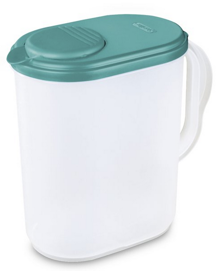

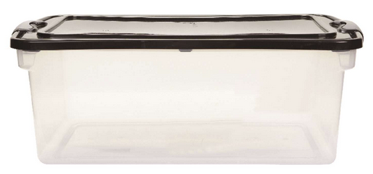

I use one of these:
... and one of these:
Homz Latching 10.625 in. H x 16 in. W x 28.75 in. D (approx 20 gal) Stackable Storage Box - about $15 at Ace - and a
1 Gal. Pitcher - about $3. First, I put a big, flat piece of cardboard on the shop floor to catch any drips or splashes and to make sliding a tubbafulla oil a little less jerky. The lid goes on after the fluid has drained and also helps keep the oil from sloshing out when I slide it out from under the machine. I use the pitcher and a funnel to transfer the oil into the empty HST containers after the tractor's been refilled. When I'm all done the pitcher goes into the tub, the lid goes back on and the whole shebang gets tossed up into the storage loft, so it's ready for the next truck or tractor oil service.

I went to TSC and bought one of those rubber / silicone 16 gallon totes, in a wonderful turquoise color I might add. I set it under the hydraulic drain and let it fill up. I then fill my tractor and pour the oil from the tote back into the buckets that I used to fill the tractor. I think the tote was around $18.

Homz Latching 10.625 in. H x 16 in. W x 28.75 in. D (approx 20 gal) Stackable Storage Box - about $15 at Ace - and a 1 Gal. Pitcher - about $3. First, I put a big, flat piece of cardboard on the shop floor to catch any drips or splashes and to make sliding a tubbafulla oil a little less jerky. The lid goes on after the fluid has drained and also helps keep the oil from sloshing out when I slide it out from under the machine. I use the pitcher and a funnel to transfer the oil into the empty HST containers after the tractor's been refilled. When I'm all done the pitcher goes into the tub, the lid goes back on and the whole shebang gets tossed up into the storage loft, so it's ready for the next truck or tractor oil service.
For baling oil I just use a used 2 gal oil/hydraulic fluid jug with the bottom cut off --- and the cap still on of course.
