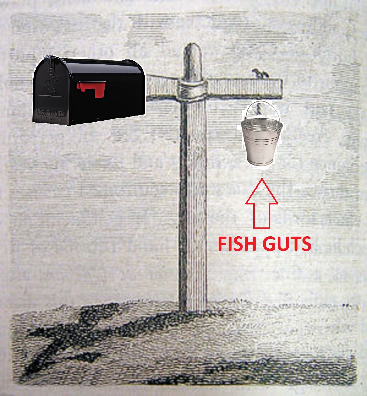

I have an idea for an invention. Ever heard of a Quintain? Its a shield mounted on a post that swivels with a counter weight sandbag. Horse mounted jousters used it for practice. If they were not careful, they would get whacked with the sandbag. Same concept, except the counterweight is a bucket filled with fish guts or some other stinky unpleasant substance. Mailbox takes a whack, post swivels, and bucket loses its contents onto the mailbox basher and his open vehicle window. I have attached a diagram. 300px-Hasted_Quintain_Illustration_1798.jpg

I have an idea for an invention. Ever heard of a Quintain? Its a shield mounted on a post that swivels with a counter weight sandbag. Horse mounted jousters used it for practice. If they were not careful, they would get whacked with the sandbag. Same concept, except the counterweight is a bucket filled with fish guts or some other stinky unpleasant substance. Mailbox takes a whack, post swivels, and bucket loses its contents onto the mailbox basher and his open vehicle window. I have attached a diagram.View attachment 534468
