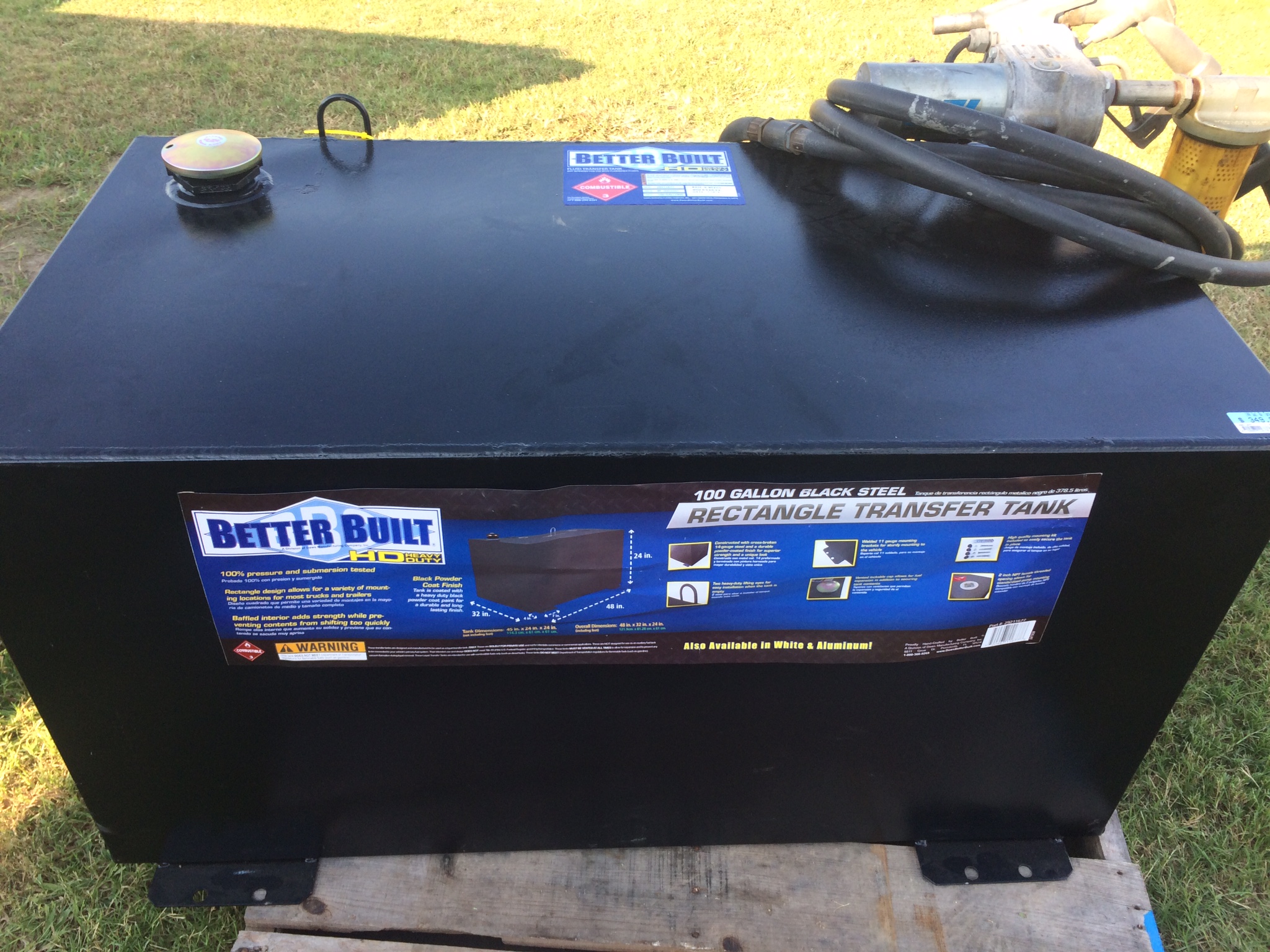

Already have one of those on it. Changed the filter twice already. The bottom of the plastic bowl had about 1" of mud (rust) in it.
No one mentioned it but it's common knowledge that you keep the pickup und about an inch or inch and a half off the bottom of the tank. Also, the pickup end is cut on an angle.
The end of mine is cut at an angle. I'm not sure how close to the bottom it was, and it is adjustable. When I go back in with it, I'll make sure it's about an inch off the bottom.

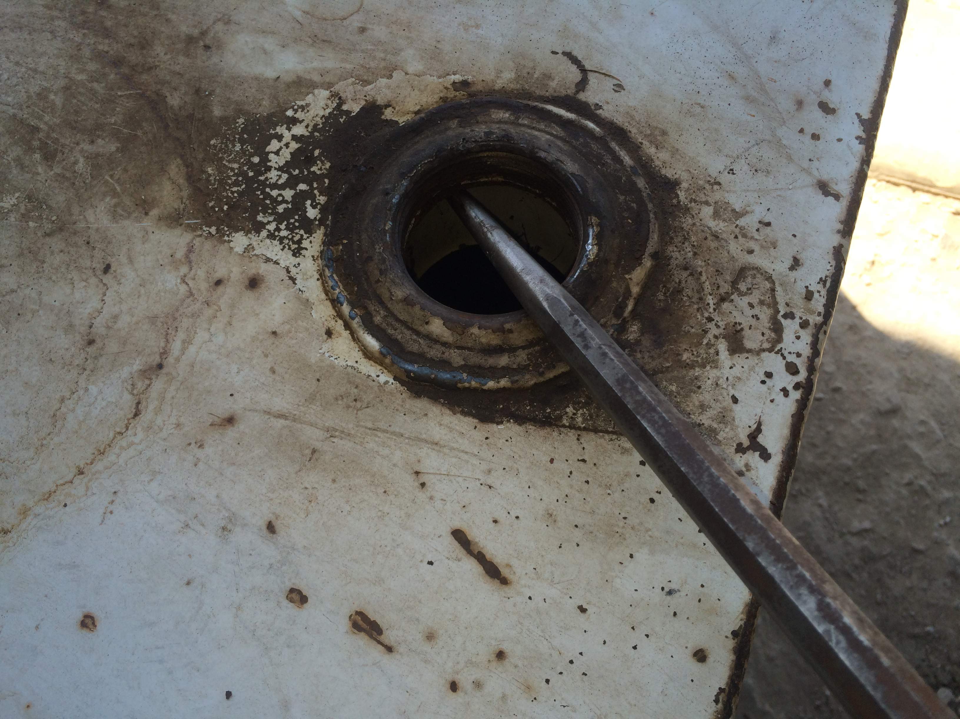

Today, I punched some holes in the tube extending down into the tank (see pic below). Then I flushed it several times using a total of about 3 gallons of clean diesel. I think that by punching the holes I was able to get most of the liquid out each time. I'm going to let it set on my pallet forks upside down for a few days then probably try it again. I'll keep a few spare filters on hand.
In the mean time, I'm watching Craigslist for a good used aluminum tank.

Well....I chickened out on using the old tank and just bought a new one. Found a very similar tank at Tractor Supply on sale for $300, which is $50 off the regular price.
I picked up about 2 weeks of work with my tractor and need to start tomorrow, so I didn't have time to fool with the old tank and I didn't want to take any chances.
