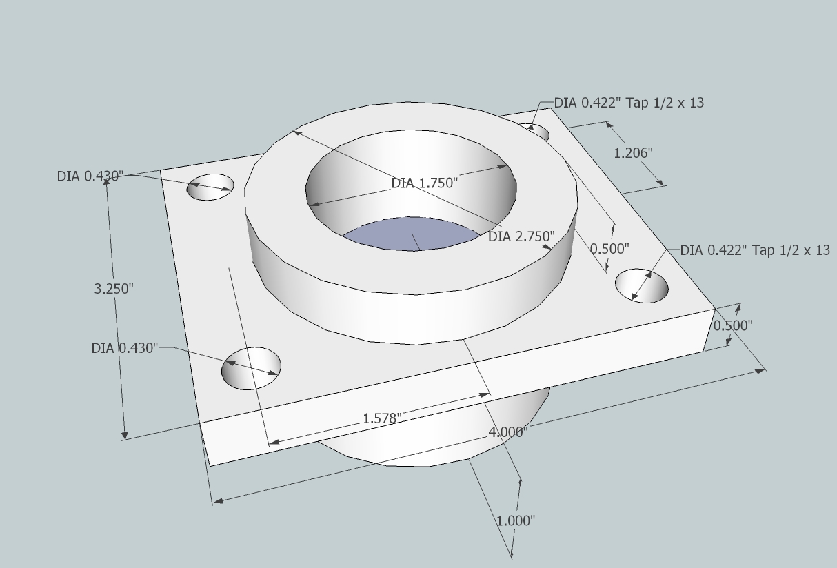

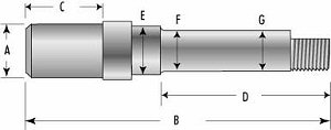

See Sketchup drawing at bottom. A purchased spindle (second picture) slides in to this hub adapter and is welded.
Not knowing what tooling you have for your lathe I will make a suggestion.
Chuck the targeted plate in your 3jaw chuck.
I assume you mean 4 jaw chuck.....
Make sure it is sitting flat in the chuck jaws so you dont cut a eccentric circle.I use a spring loaded dial caliper with a magnetic base for this, just check the plate on all four side amd make sure the reaidns are the same all the way around. If you have a drill chuck to use with your tail stock, take a bitmetal hole saw smaller than the desired spindle dia and chuck it in your tailstock. Using your lathe slowest speed slowly feed the hole saw into your material. Once you have cut thru your plate, remove the hole saw and attach your boring bar to your steady rest and slowly open the hole to the desired dia. Once desired hole size is reached,you can use a cutting bit in your steady rest to mark your bolt circle for the lug bolts. Just open the cutting bit up to the desired bolt hole dia and lightly score the plate with the cutting bit. This will ensure your bolt circle is centered with your spindle dia. You didnt say how many lugs your hub has but you can use a drawing compass, the little thing you used in school with a needle on one side and a pencil on the other, and a tape measure to accurately mark the location on your new bolt circle. Each lug will be evenly spaced if measured correctly. Once lug pattern is marked, centerpunch with sharp punch and then drill to desired size. Notice, no chucking and rechucking the piece in your lathe.
I like this suggestion. My biggest worry is that the bimetal saw will die before I get two holes in two plates. Flange bolts are symmetric but not evenly spaced, but I think I can lay them out with enough accuracy, as the flange is centered on the pilot of the OD of the pipe.

Thanks, Kim. I have Chinese carbide cutting tools, but I don't think I'm up to the face grooving technique.
Looking at my design above, what kind of tolerance is reasonable between the trailer spindle that slides into the center and the hub?

I assume you are welding the spindle to the back side of the plate. Seeing how the plate is only 1/2" thick, I would keep it a close fit. It could even be up to a couple tight and you could heat the plate to install it. Your .002 clearance would be fine.
Kim
Thanks.
How about the clearance between the 1.75" spindle itself and the 1.75" hole in the center of the adapter. I have 2" overlap there. Looser OK?
