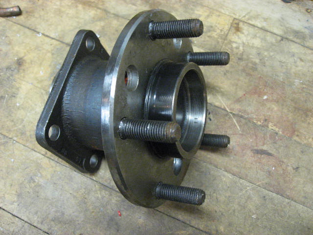

Can you not just redrill the existing hub for the new stud pattern.....
Unfortunately, no. The long of it is that it is a UHaul trailer. They used a flange on the axle (1st picture) which adapts to a Camaro front bearing hub (2nd picture). It is very robust, but has no brakes. I looked at every possibility to add brakes and decided that I needed to get to a standard trailer spindle setup (3rd picture) so I could just use off the shelf electric brake hardware. The hub in the sketchup drawing is my adapter from the UHaul axle flange to the standard trailer spindle. I will mount the brake backing plate to the hub when I bolt it all up.

Thanks.
How about the clearance between the 1.75" spindle itself and the 1.75" hole in the center of the adapter. I have 2" overlap there. Looser OK?
I'd try for .002 -.004 or so. The more the support it has the better.
