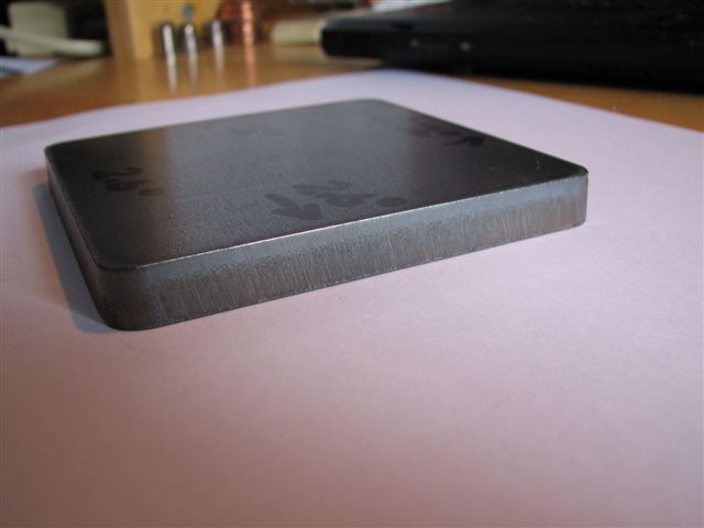

Powermax45 edge angle 003.jpgPlasma cut on 3/8 steel. I wouldn't call it terrible and I see no need to grind it. Cut with a Powermax45 from Hypertherm. 30 inches per minute cut speed.
Jim
Your absolutly correct. BUT, he wanted and needed, for his application, a nice........neat............straight.............cut. If he cut it with a torch or plasma cutter the cut would be terrible and he would be required to grind it. I repeat...............All other ways would fail to meet his needs..........................................................................................................................Frank

Oh, and here is some heavier stuff cut with same plasma...3/4" steel on the left, 1" on the right....with bevels cuts as well. The hardness of the steel has no effect on plasma cutting...I cut AR500 plate often.
Of course not everyone has a plasma.....however most that have one will do a 4 second cut like the OP was doing.....for free.
Jim

jimcolt said:
<img src="http://www.tractorbynet.com/forums/attachment.php?attachmentid=303919"/>
Jim
even my powermax30 did a passable job on a 1/2 x 5 snowplow cutting edge. Wasn't sure it would do it. Nice surprise that it could.

View attachment 303919Plasma cut on 3/8 steel. I wouldn't call it terrible and I see no need to grind it. Cut with a Powermax45 from Hypertherm. 30 inches per minute cut speed.
Jim
Dang Jim that is pretty, If you tried to "clean it up" you would just "mess it up" that is beautiful.
