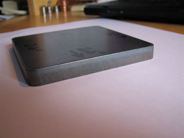

OTOH, the cut from my 14" Dewalt chopsaw is even smoother than the plasma cut.
0.065" cutting wheels in any one of the 4 angle grinders around my shop would give a cut quality nearly as smooth as either of the the big chop saws.
FWIW, I personally would never attempt to cut AR cutting edges with any kind of bandsaw or recip saw - too hard on the blade. But then I have 4 or 5 other, faster means to cut this kind of stuff.
