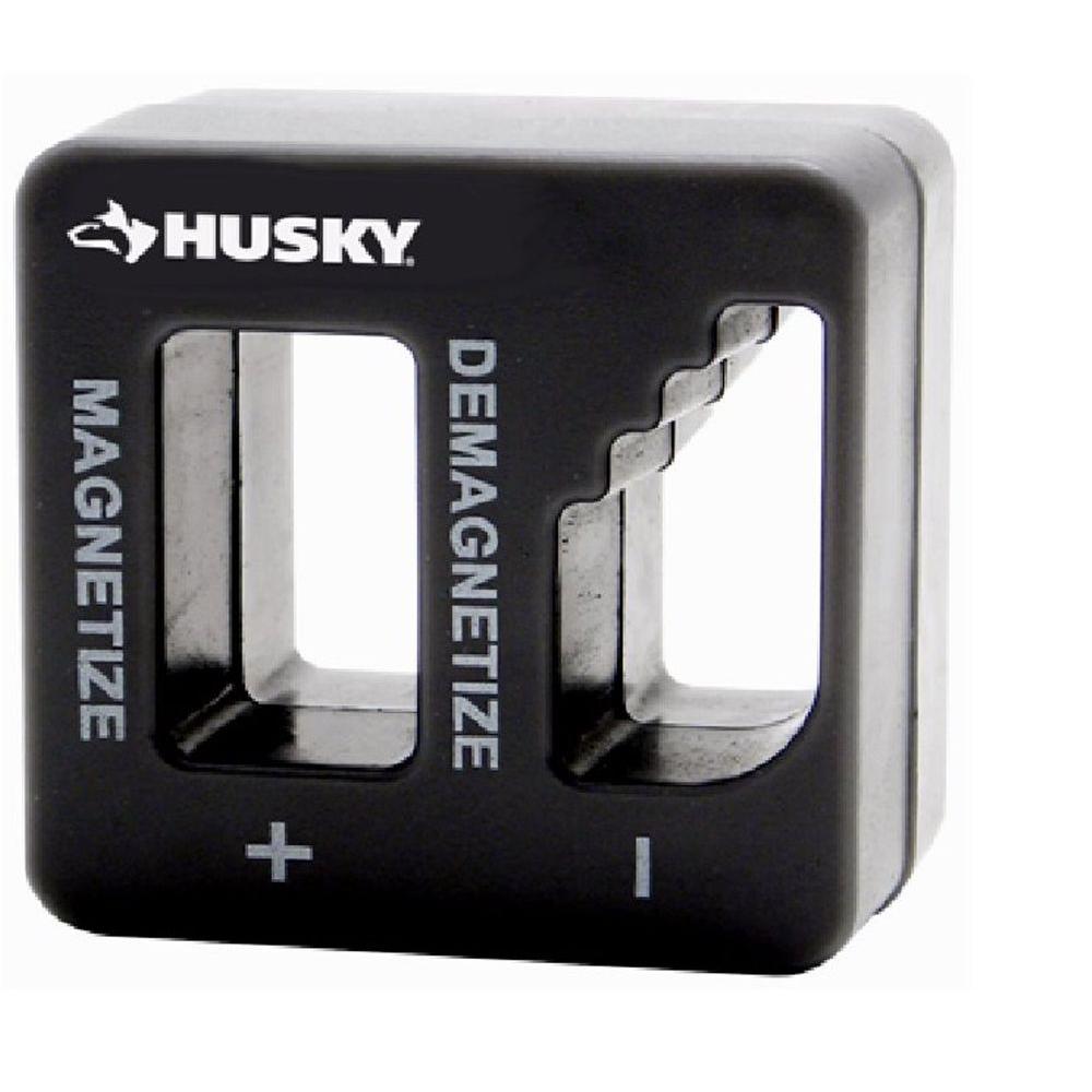

/ How to DeMagnatize Stuff ?? #7
For drill bits stop by your local Home Depot and pick one of these up.
Husky Precision Magnetizer Demagnetizer-361H - The Home Depot
They are used for magnetizing and demagnetizing screwdrivers but I would expect that anything that will fit through the opening will work. Plus they are dirt cheap.
Thanks for all the helpful info. You guys are great. I had no idea about this stuff and read thru it. I tried to disorient the magnetic field in the bits by putting them in the drill press and let it run while I held the same magnetic clamp perpendicular to the bit and ran it up and down the length of the bit. It must have scrambled up the field because they are no longer magnetic. Thank you !!
Next time I am in Home Despot I will look for one of those inexpensive Magnetize/Demagnetize gismos.
