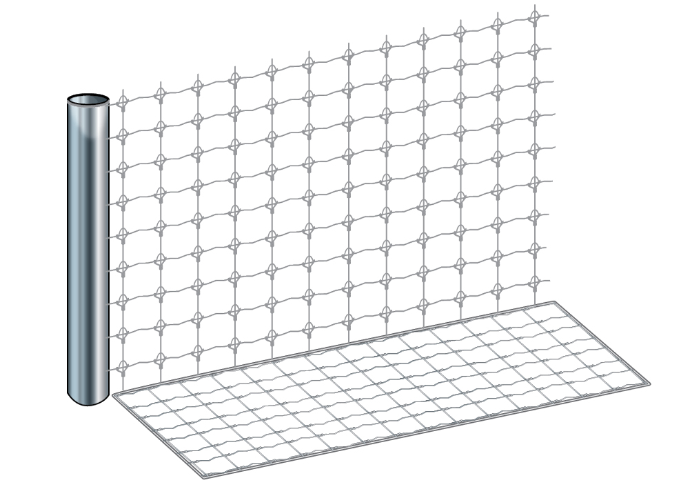

Some have said that snares are the only way to kill them. They will cut a piece out of their fence to trick the coyote to come through there and catch it in the snare. Others have said that you will never kill enough of them to make a difference, so you have to put more effort into fencing to keep them out. The most common way to fence them out is to roll a lenght of fencing on the ground so it's flat, then put your fence up on the inside part of the rolled out fence on the ground. Most use 32 inch tall fencing for the ground part, which means your standing fence needs to be 32 inches inside your property line. I hate the idea of losing that much land, but haven't been able to find another way that is better. Then you connect both fences together. Staple down the flat fence into the ground and hog tie them together.
When the coyote goes to dig under the fence, it hits the fence that is laid flat on the ground. It will never go so far back as to dig under that fence, and will be unable to get through the wire on the ground so it can tunnel under the standing fence.
Here is a picture that shows what I'm saying.
