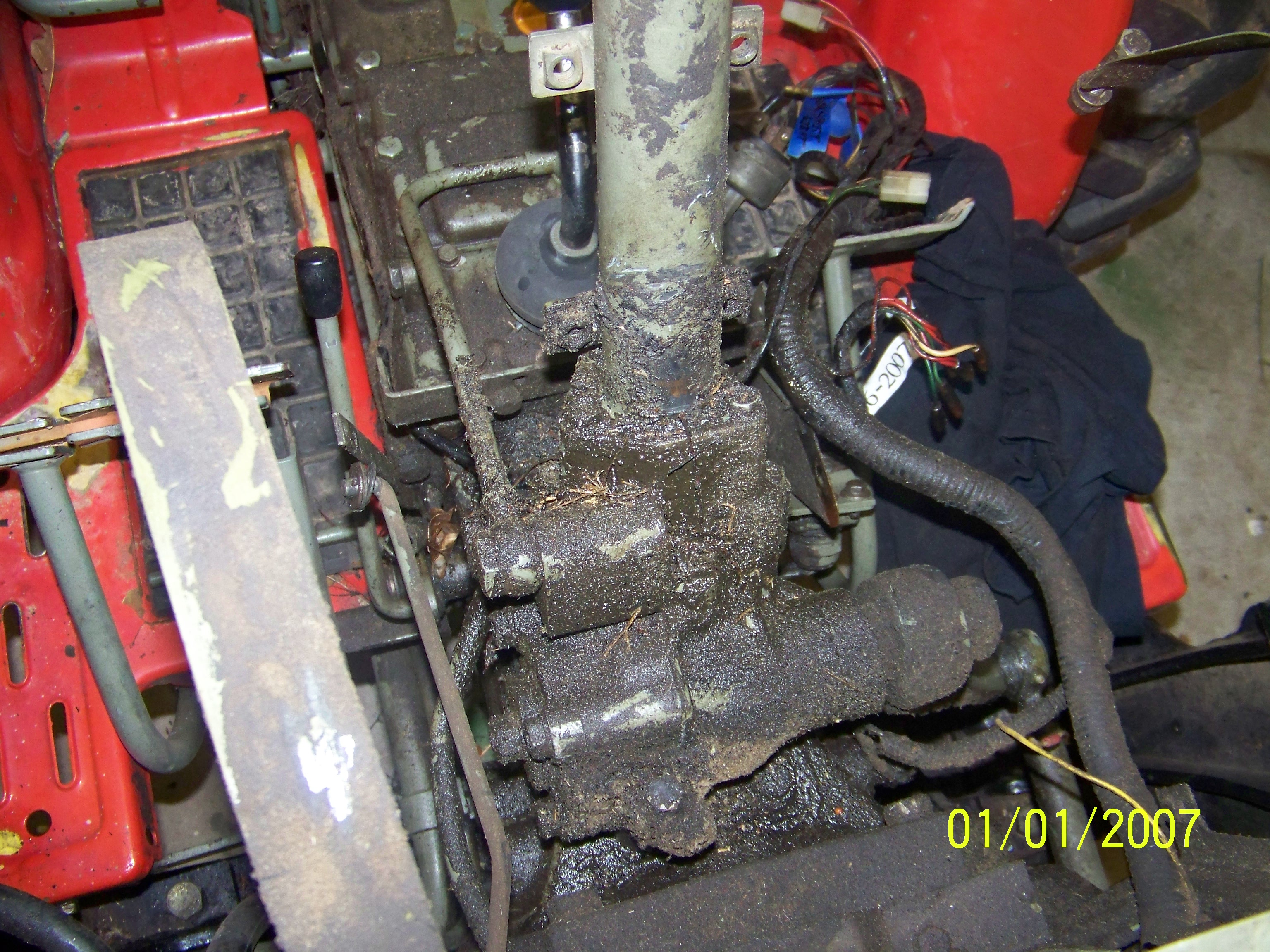

I made a mistake I believe. I used 90wt. gear oil. Not 303Hyd. May want to still check into what is calls for. I tried Hoye and found the Front Axle used 90wt. So I believed that's what I used. Been awhile,10yrs. if not more......

Gearbox power steering was an option on the 336 so I would believe it was on the 330 as well. If you have it you will find hydraulic lines going down to the steering gear box.
I had this option on my 3110 D

I expect they would be scarce as hen's teeth. :D You would also need the diverter box that is a part of the system and the lines are sort of special. (hard tubing)
   / How to determine if Yanmar 330D has power steering #17
You could run hydraulic lines in place of the tubing if you found the rest.
   / How to determine if Yanmar 330D has power steering #18
   / How to determine if Yanmar 330D has power steering #19
I bet a hydraulic shop could get you some ends
