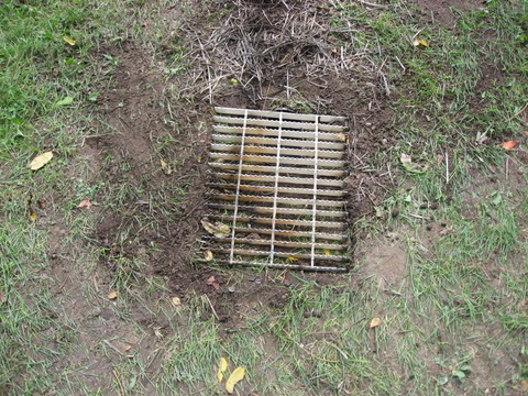

UPDATE
OP here. Thanks for all the great suggestions and comments.
I decided not to run the surface drain through the french drain pipe. Instead I ran a second pipe in the same trench then tied them together with a Y fitting just before the exit. I was warned that the surface drain would distribute water through the perforated pipe exactly where I am trying to eliminate it. Made sense, so two pipes most of the way.
I went to my favorite scrap yard looking for a ready made grate and spied a nice piece of catwalk. It has a grippy surface. So I cut a rectangle and laid it over the cut down plastic pipe in a recess in the soil. I did not stake it, but will if the grass growing through it doesn't hold it tightly. Last picture is before I cut down the pipe.

I think you would have been OK with just cutting the pipe flush with the ground and letting the grass grow around it. Alternatively, you could get a peat plant pot about the right size to fit into the pipe opening and put dirt and grass seed around it. This will recess the pipe slightly within the sod. Once the grass is established trim away the end of the peat pot and you won't even know the pipe is there.
