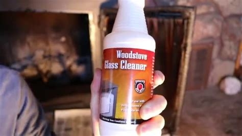

Hello to all,
I;ve done some research on this, but thought I would give it a shake w you guys to see if you have the solution.
Have a 2002 22" Dutch Vermont wood burning stove...it's awesome. For the last 10 yrs, I get this haze on the bottom, that has now further up and to the center. I have used cleanser and water w paper towels, but that only gets what was recently put on the glass. The hazy part just seems to get bigger over time.
Is there a real solution, or buy a new glass?
Or, is there a cleaner w a fair amt of elbow grease that works?
Or, do I get a oscillating polisher w very fine polish?
I would appreciate your help on which way to go...I have a polisher and various attachments w polishing pads. Questions?

I use white vinegar and a paper towel.

I have a bit of haze on my wood stove glass as well, I think it might be from the heat, not sure though. I find the best way to clean the glass is with a slightly wet paper towel and dip it into the fine part of the ashes and then wipe that on the glass and scrub a little. Then wipe it clean with just water on a fresh paper towel. It's cheap, easy to use and does a pretty good job. Then just throw the used towel into the wood stove once it gets burning nicely.

i use some easy off degreaser/ oven cleaner. works great.

There are two kinds of haze I have found.
The first occurs quickly , like in days and can be easily removed in the ways already mentioned.
The second occurs over the years slowly as the stove ages with time and many fires. I believe it is IN the glass not ON it. Don't think there is anything can be done in this case.
   / How to fix a hazed-up wood burning stove pyro-ceramic glass #9
New glass may be needed if its too far gone.
When the glass is cold I use a paper towel and water. Seems to work just as well.
   / How to fix a hazed-up wood burning stove pyro-ceramic glass #10
Yeah, it's almost like the inside of the glass is etched. Doesn't really bother me. I'll clean it once a year in either the spring or fall. Stove is in use continuously once it gets cold.
