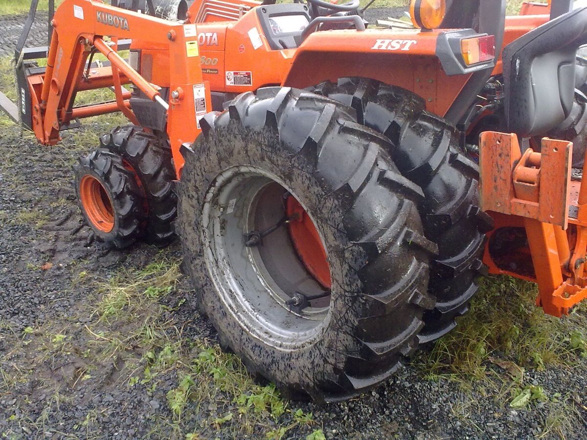

I found an extra set of full size front rims and bought the smaller set of tires n rims. I cut off the outer part of the extra full size rims, had the welding shop in town roll me some plate so it was slightly smaller than the rim on the little wheel. I welded the rolled plate to the smaller rim after cutting the center out of that and then put the cut out center of the larger rim to the other side of the rolled plate. Had to get longer studs and both wheels now bolt thru the same studs. It works well in the soft but watch it as there is a lot more torque as a couple of bent tie rods will attest to until I learned not to dig into tundra with 4 wheel drive. The fronts don't do much for stability but they sure keep the front end up in sand, mud, and snow.

Cariboo Dave
your a creative guy.
thanks for the pic and explanation.
Rear dullies are beginngin to make more sense. As you say fornts wount do so much.
have you weighted the tires?
   / how to get better stability? #23
I originally weighted the outer rear ones but have to take them off to get the tractor in and out of the skiff and they were too darn heavy putting on/off plus never really felt I need the extra weight as the back hoe is on most of the time. I also cracked the center disc on the inner tire, I think now it was defective from factory, and had to add some reinforcing to the disc. Not sure but when the disc cracked I took the antifreeze out and never put it back in and haven't missed it. I cut some reinforcing for the other side but never welded it in and it is still fine.

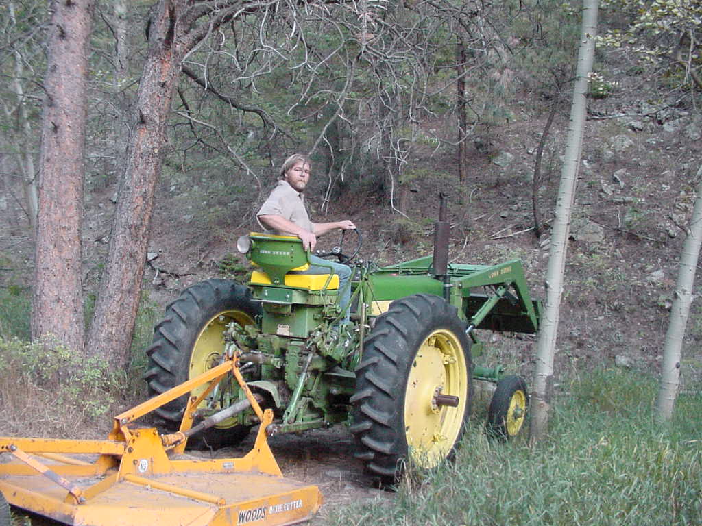

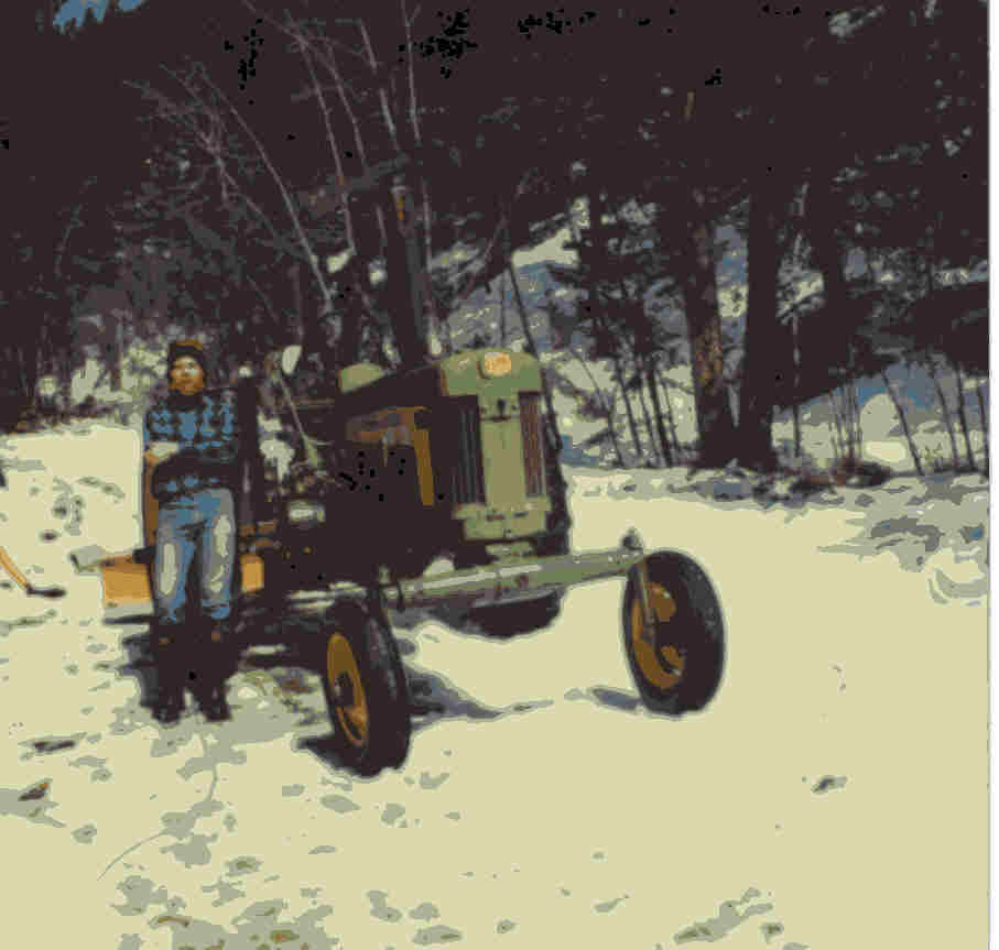

I use my old Ferguson TO35 for mowing instead. On hills where the Yanmar scares the bejesus out of me, the much wider tread width of Fergy doesn't even cause me to raise an eyebrow.

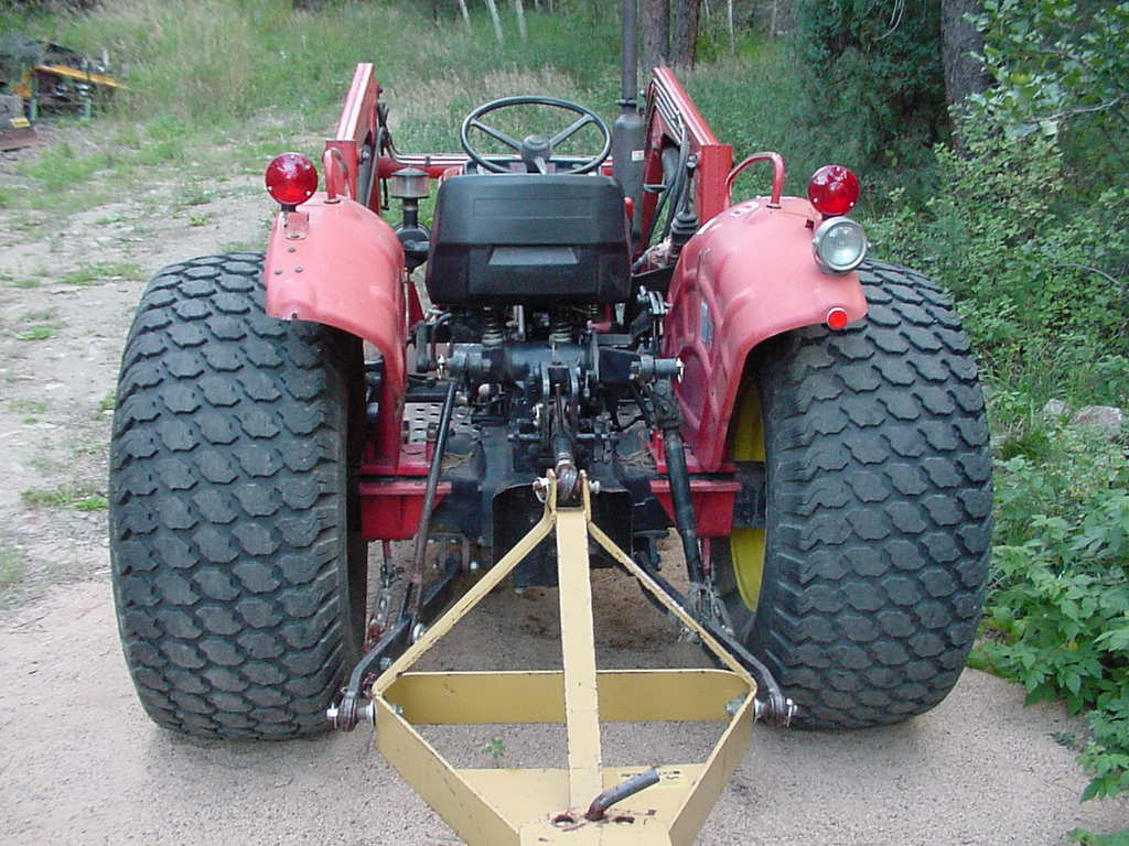

Same thing here. For work on hillsides I use an old US made John Deere two cylinder. Both Yanmars have wide turf tires BTW, turf tires come in wide and narrow. The pic below shows the wide ones on a YM336D. Get the wide for stability. Anyway, both Yanmar's are still limited on side hills. But the ancient John Deere farm tractor handles hillsides fine. It's already got a wide stance with the weight down low enough so that here in the mountains I've never found a reason to extend the front axle or move the rear tires all the way out. If I did that it would really, really be wide!
Like a lot of tractors with an adjustable width front axle it has telescoping tie rods too.
rScotty
