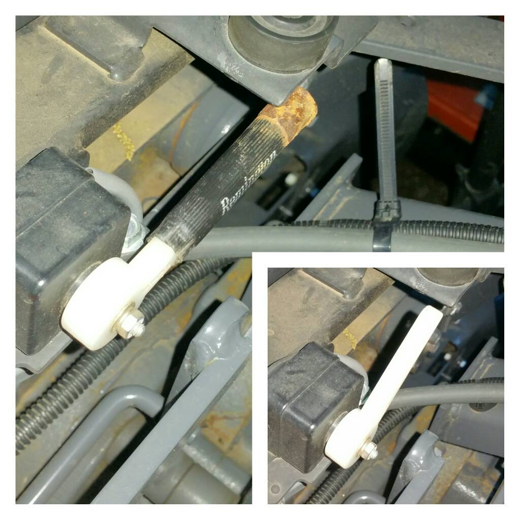

I use pallet forks on my tractor a lot. Sometimes I need to stand to get a better view while running the forks under my load. I had a spent 410 shotgun shell in my pocket the day I decided I had had enough of my tractor cutting off all the time when I was trying to do loader work. The shotgun shell fit right over the little arm of the safety switch. It was just long enough to hang under a seat support and always keeps the safety switch held down. You could also use any small tubing or pvc pipe to achieve the same results. This same shotgun shell had been on two tractors now. When I upgraded, I moved the shell from the old tractor to the new one. uploadfromtaptalk1464832054934.jpg

I use pallet forks on my tractor a lot. Sometimes I need to stand to get a better view while running the forks under my load. I had a spent 410 shotgun shell in my pocket the day I decided I had had enough of my tractor cutting off all the time when I was trying to do loader work. The shotgun shell fit right over the little arm of the safety switch. It was just long enough to hang under a seat support and always keeps the safety switch held down. You could also use any small tubing or pvc pipe to achieve the same results. This same shotgun shell had been on two tractors now. When I upgraded, I moved the shell from the old tractor to the new one.View attachment 470525
My Kubota has the same switch. Have a zip tie instead of a shotgun shell. I stand a lot to see the tips of my pallet forks.
