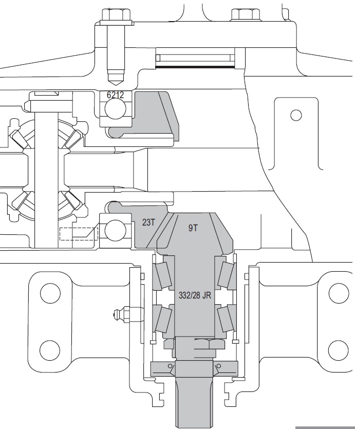

Also, Coyote machine, you mentioned pumping lots of grease into the front axle pivot zerk and nothing coming out. Probably coming out inside of the drive shaft cover. Have a look here, you can see how it can get there.
Great! Good info. Thx!
