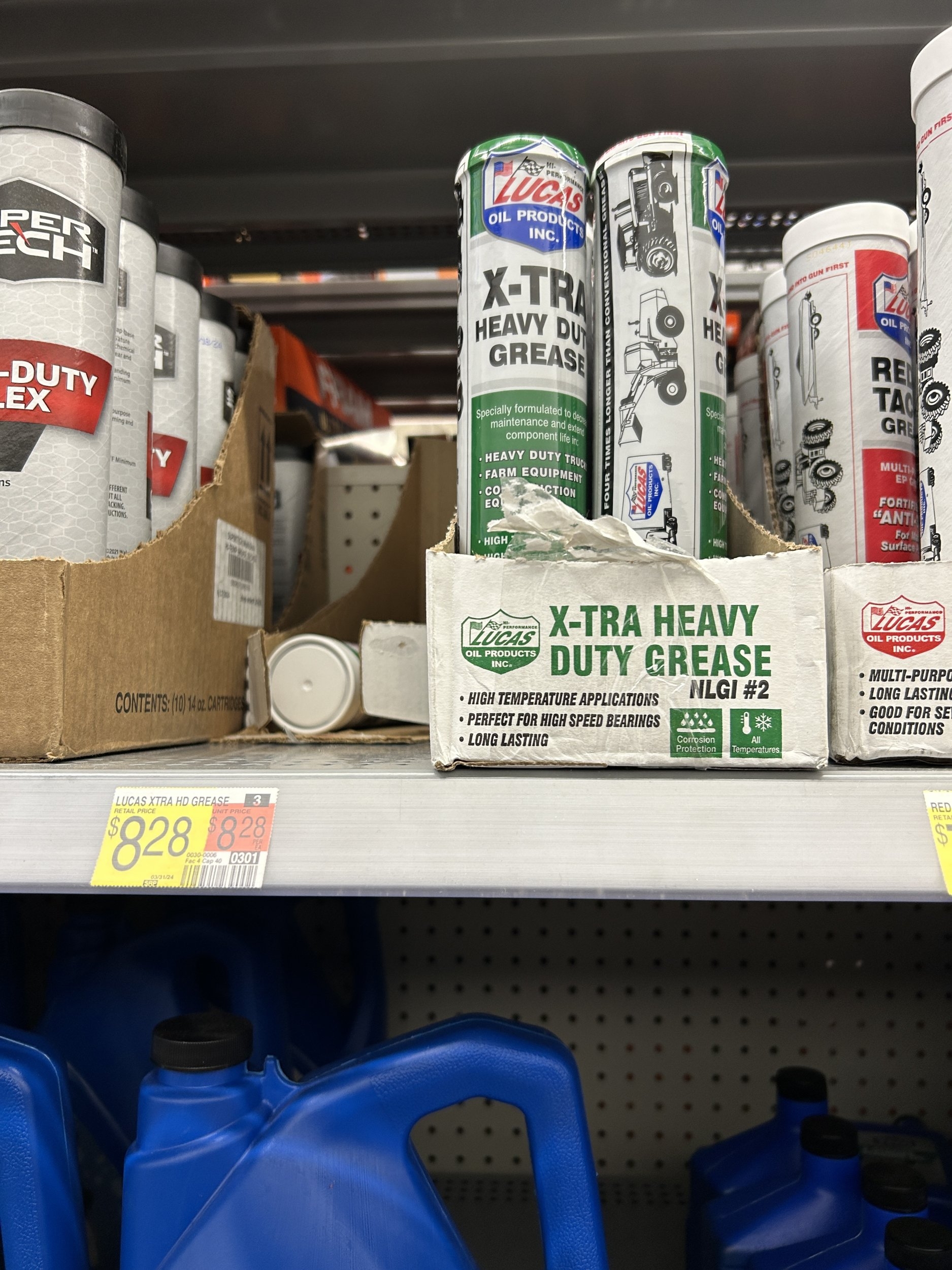

Looks like Lucas Extra Heavy Duty polyurea based is back on the shelves at Walmart. I just bought some a couple weeks ago.
I use the Red 'n tacky lithium based for just about every zerk fitting except mower spindles and my disk harrow which sits outside. Auto and truck wheel bearings get Kendall Super Blue lithium base out of the same big tub that I bought back in 1982. Never had a wheel bearing failure.

I picked up a couple tubes of Lucas Xtra Heavy Duty at the local Walmart just yesterday. There was plenty more on the shelf. I’m hoping that maybe the shortage is over. It was somewhere between $8 and $9 per tube.
/ Grease Compatibility Hell #48
Yeah I bought some at Walmart last week. The factory that made the additives burned. I guess it’s operational again.

I used to always get it at Home Depot. Reading this thread made me curious so I checked today and they have it in the store. $6.48 each.
