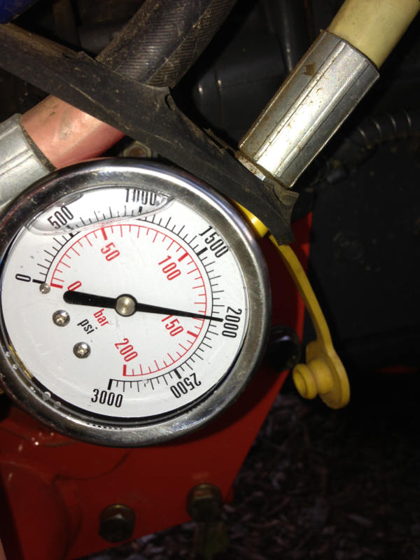

Ok... Finally got to a pressure test. 2000 psi at red line... Tested at the loader. Still would like to bump up the pressure just a bit. Where exactly is the pressure relief valve on the b2320?

You will most likely be fine you up to 2100-2200, but I wouldnt over do it.
Others will have to chime in on the location. But FWIW, on my L3400, it is on the block where the hydraulic filter is under the right foot-board.
   / How to increase loader lift capacity #39
maximus1277,
Show us a picture of your loader valve.
On most loader valves, the relief valve is close to the input hose.
Some reliefs are on the hyd block.
IF you have remotes, that valve will have a relief valve.
#40
I found it... the valve is tucked in on the right side of the transmission housing... I will swap one shim and recheck the pressure... Thanks for all the help.
