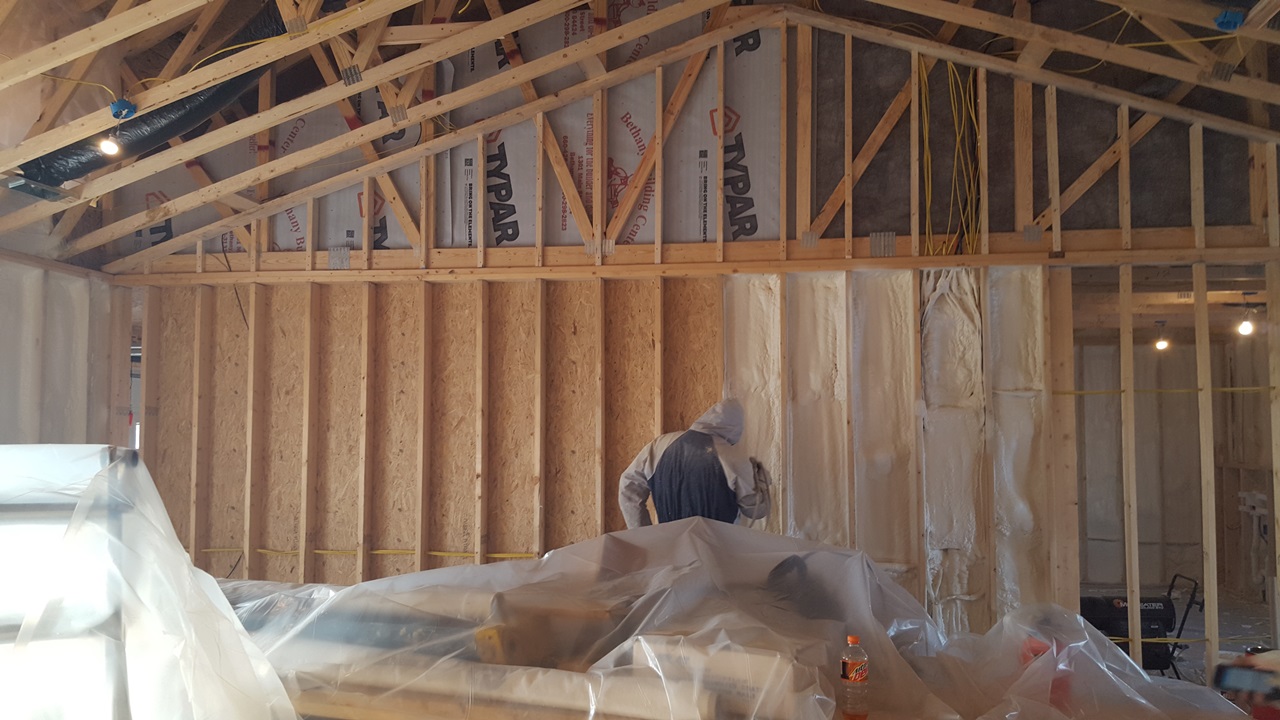

Build a 2X6 wall on the attic side of the truss and insulate it normally. easy peasy and you only loose 5 1/2" of attic space.
   / How to insulate the wall between cathedral ceiling and attic? #16
We added 2x4 studs to the "in" side of the trusses. Put Tyvek wrap on the attic side. Spray foamed the Tyvek for air transfer control. Bat insulated between the studs for R-Value.
Since you are as far along as you are, you would have to add the studs to the attic side of the truss as suggested above.
Understand this about Spray Foam. It has very little R-value. R 6-7 per inch. So you need to do something additional if you want more R value.
We sprayed 2" of foam (R value 12-14) and added 3.5" faced Batt insulation (R value 12) for a total R value of 24-26 and air tight.
